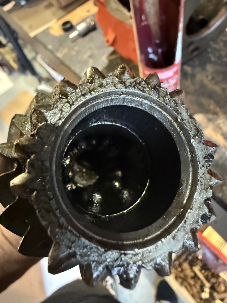

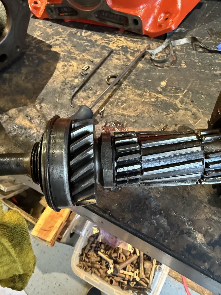

I bought a full kit but I'm not going to use it, just the seals and gaskets and bearings I need. For the life of me I cant figure out why the shafts wont go back together, If i have the needle bearings in them like they came out, it stops a quarter inch short. If I take the needle bearings out, the tailshaft goes in fine. Its the weirdest thing

Pics

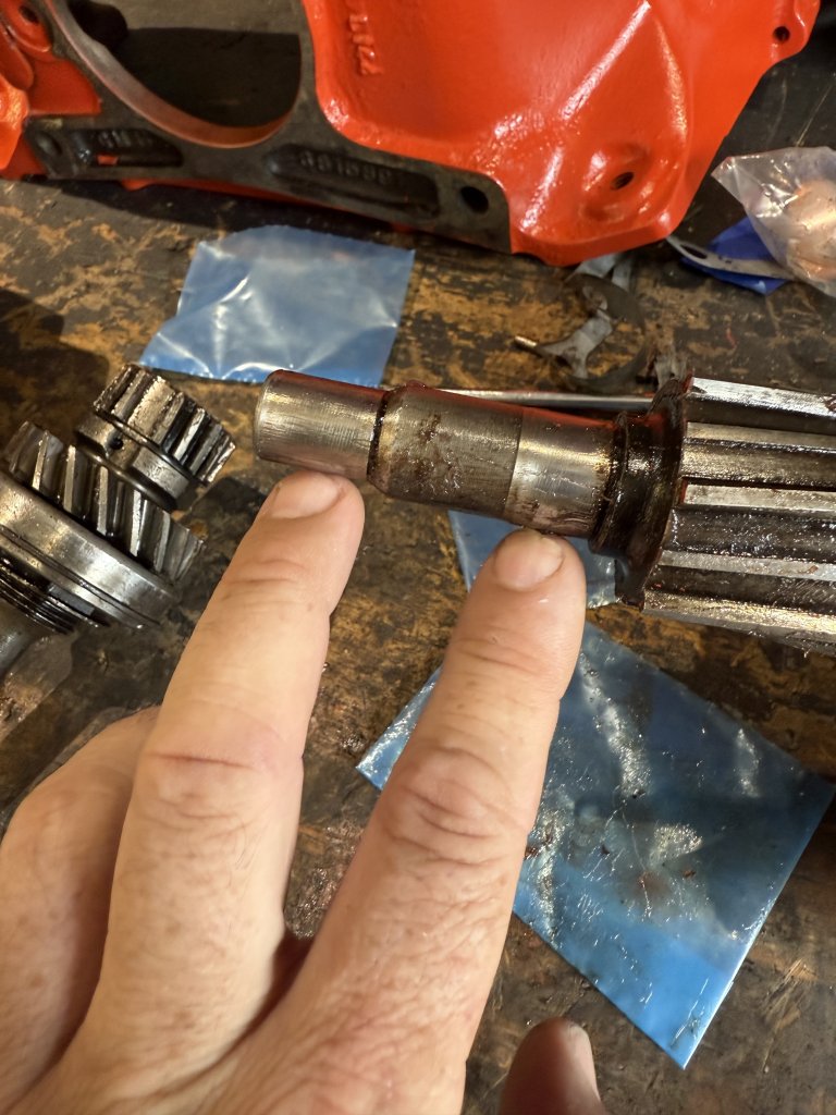

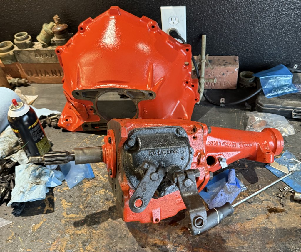

Figured out the trans needle bearings, and got it all back together. I hope it works right.

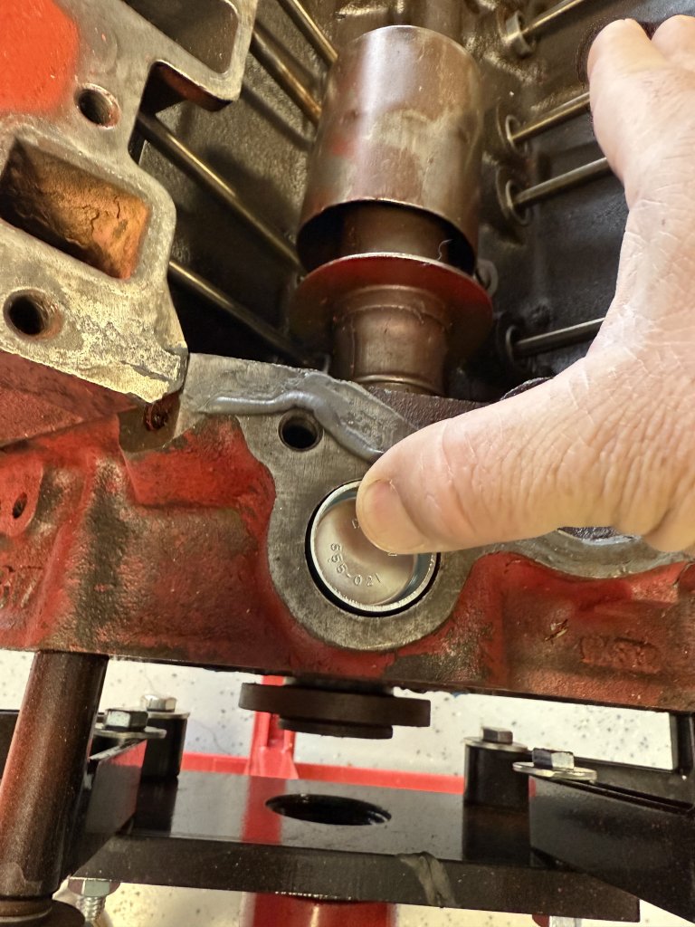

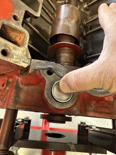

My freeze plug for that hole in the back of the block by the distributor is too small so I’ll have to special order another size or three.

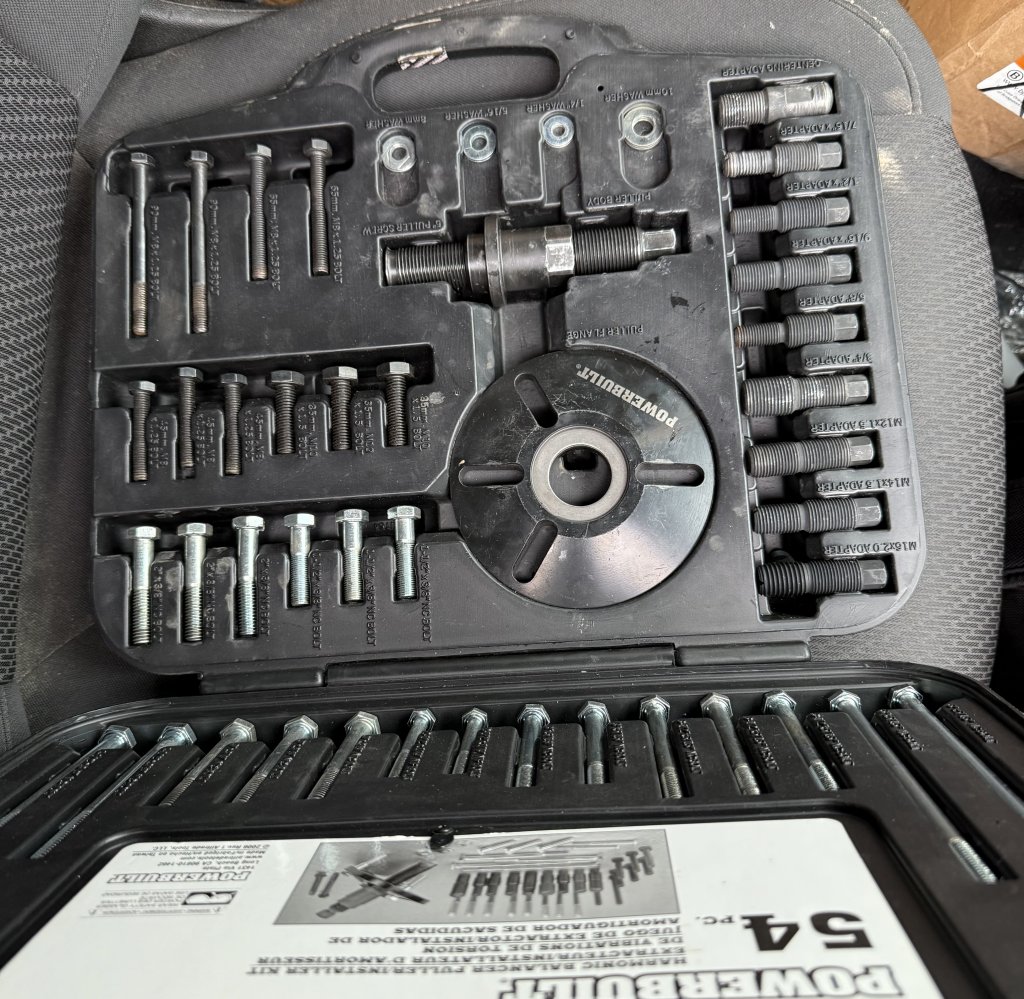

Paid $140 to rent a 54 piece installer remover set and it doesn’t have an adapter near the size for my crank. Going to take it back and go to Harbor freight. New dampener is in though and ready to install

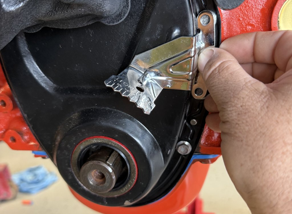

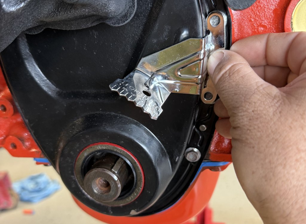

Did get the little timing tab in the mail.
Slow going over here

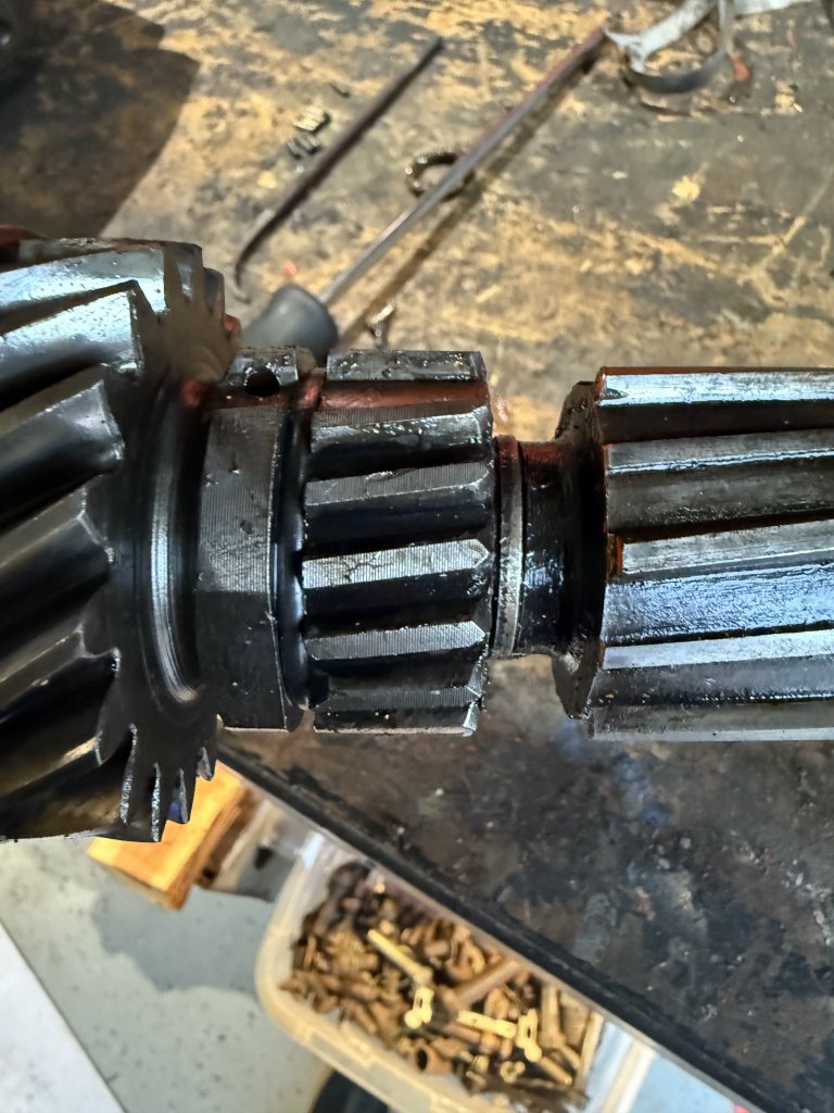

Trans
The two light colored spaces where my fingers are pointing is where the needle bearings sit on the female section of the other shaft. I was trying to put a set of needle bearings on that middle dark piece and it wasn’t going. Once I finally looked at the shaft and realized where the riding surface was. I figured it out and got it back together.

@1low4x4 do you still have the tube that was in that hole in the back of the block? If you do, reinstall it, and cap it???
1low4x4
Feb 14, 2011
2,907
1,686
Nick
1965
283
Wasn’t on the engine.
I was able to find the part number that supposedly fits, 555-024
1low4x4
Feb 14, 2011
2,907
1,686
Nick
1965
283
It had a rubber expansion plug in it that was leaking profusely
