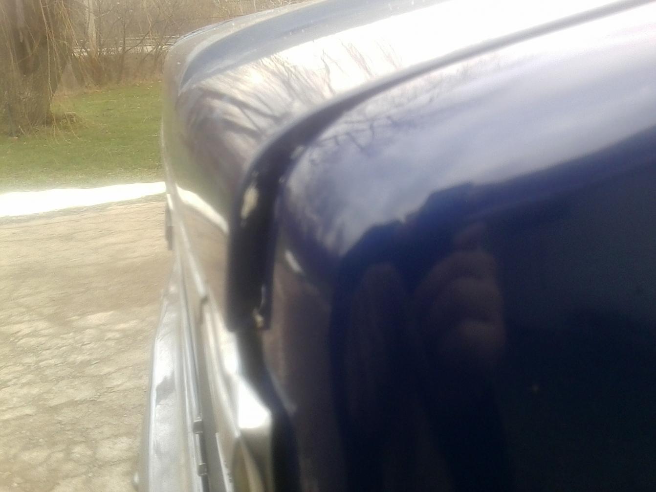

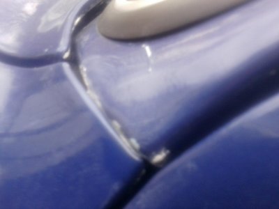

ok here are the pictures of my issue
If i move the fender forward to line up with the hood will it fix my issue??

Yup! you need to pull that fender forward, possibly from the core support, then align your hood. What condition are your body mounts in? Is it just the driver side that looks like that, or both? mine wasn't that bad, when I put new body mount bushings, I was able to line up all the body panels. You might just have a loose fender or core though.

new body mounts and new GM core support. i will try to pull that fender up. my other concern is pulling the fender up will make tha door and fender gap huge! and it wont match the other side.. My issue is on the driver side, my passanger side is fine

Get some body shims.

I agree with 89Sub, it looks like you might be missing some body shims behind that fender. If the gap between the fender and door gets too big, you can adjust the door forward a little bit too.

yep iv got plenty of shims in it now lol

Aftermarket fender?

nope all orginal GM metal
