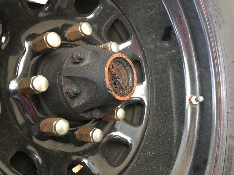

Can somebody confirm these are external 44 hubs?

Yes those are manual locking hubs. That is an old style dana 44 bolt on hub.You can get warn gold center's to replace those . That is an early to mid 70's front end.
