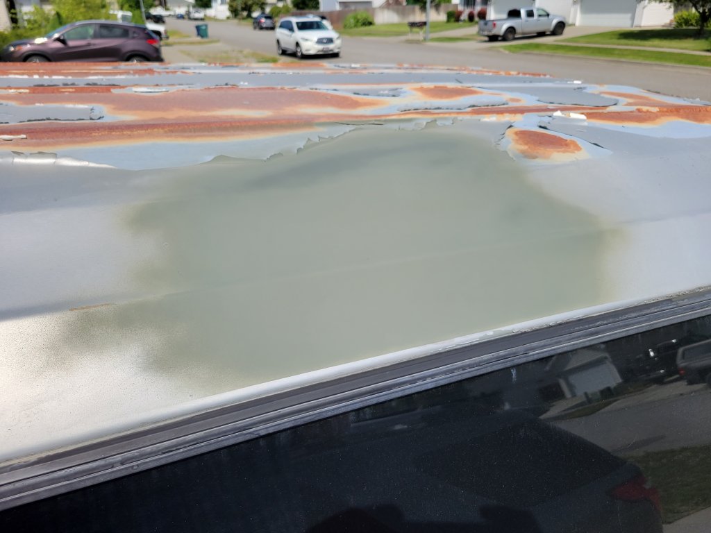

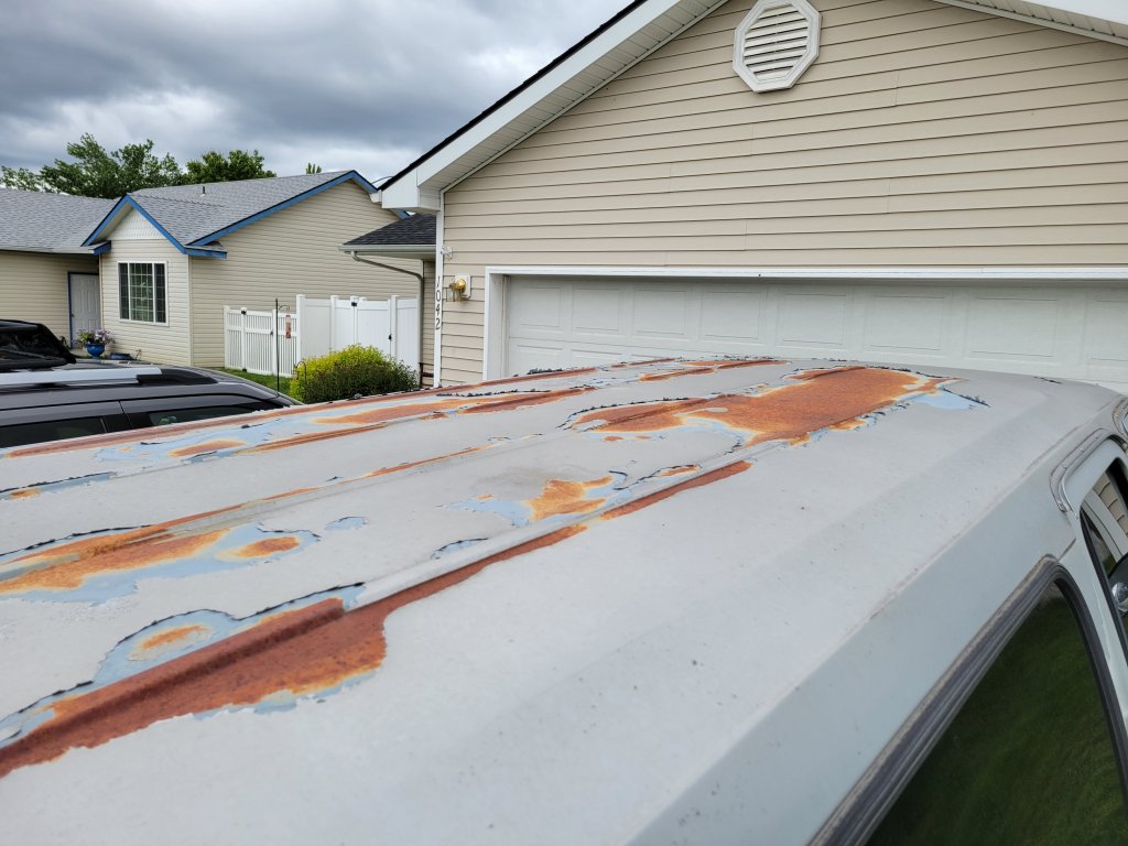

Planning on starting to clean up my roof - lots of bald spots with sun baked surface rust. I have some self-etching primer and am wondering if it's the right product, seeing as there is still paint around the bald spots, and, if it is, how far should it be prepped? Does the bald spot need to be shiny, or just cleaned up? Should I avoid getting the primer on the existing paint? (I read that the acid can make paint bubble or pickle)

Unless you are planning on painting your work immediately, you have the wrong primer. Most primers are porous and meant to promote adhesion,not protect bare metal. Epoxy primer you can shoot,and as long as you shoot a primer surface over it in the recoat window you can leave it for years without water penetrating the primer. That said,you can use that primer if it's getting a topcoat immediately. I'm not going to go into any detail as how much prep etc. That just opens the door for 4 pages ofvresponses on how everyone else would do it. Check with the manufacturer,they know their product better than anyone.

Thanks for the reply! I am going to rattle can over it. It'll look goofy as I'm going to put black over it but, at this point, I have to do bits and pieces as I have time and money so at least each patch will be protected until I can afford to have the whole thing done.
4,554
3,812
scuff off the little, wire brush big chunks. Then I spray a rust convertor on it per directions, prime and paint....of course this is spray paint and not auto paint. The rustoleum line of 2x Ultra Cover painters touch is a primer/paint all in one.....if your gonna spray paint it.
Then again, it's the roof. If your on a budget, skip the rust convertor.

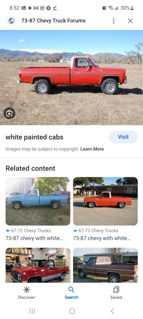

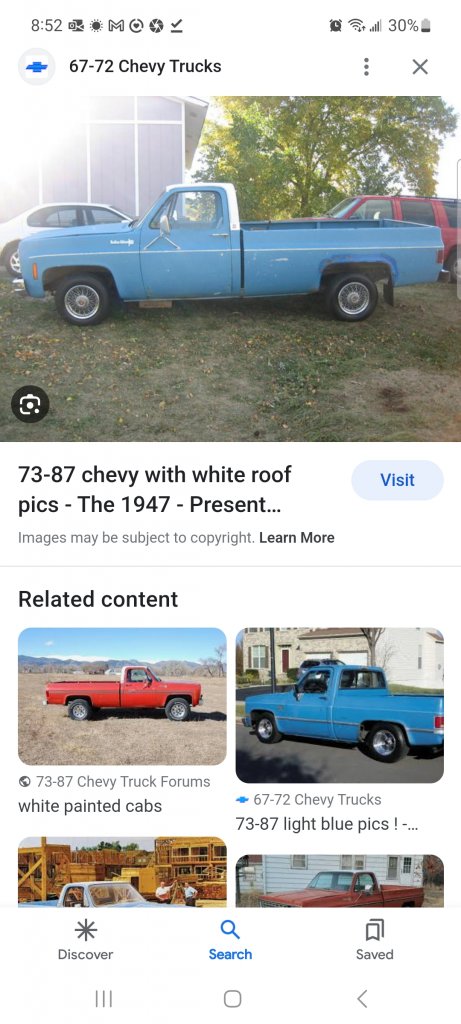

Idk what color your truck is now but white hides flaws better than any color and the icing on the cake some squares came with white roofs so it won't look goofy.

Looks like the non rusty parts of your roof are a dead match for gray primer color.
If you’re not going all in and painting the truck then don’t waste your time doing something you may have more time involved in removing later.
Wire wheel the rusty spots, clean off the roof, hang a curtain around the rest of the truck and spray it with a good direct to metal primer and call it a day. It’ll hold up for a while. Years likely.
I sprayed some primer on some old stuff sitting outside a couple years ago when I started prepping parts on the 86. Ad hoc test I suppose. Literally wiped an old paint/rusty wheelbarrow and squirted 2 coats of quality filler primer/sealer.
It’s still gray and not rusty after 2 years outdoors in western Washington. Don’t overthink it.

I did a bit of tinkering between Sunday things today. The primer I have is self etching probably should have spent more time getting scratches out of the steel, took the surface rust off with 120.
Did note that the silver basecoat is barely attached to the primer where it's not obviously peeling, so a bit of scraping before wasting sandpaper.

I apologize I didn't look at your pic,I assumed you had a c or k not a burb,a burb with a white roof would look cool,kinda k5 like. But with a burb I think Grit dogs right,don't make extra work. Sand it epoxy prime it,hit it with grey primer
And there are plenty of primers that will do all 3 functions. Bond to bare steel, high build and a sealer.
No need in todays paint world, imo, to do an etching or epoxy first.
But looks like the OP is rattle canning something on there. In that case, just turn it gray, and it will be better than just rusting.
Or in less words, if you plan on painting it for reals in the near future then don’t do much if you’re just going to have to remove it later.

I think the previous generation burb looks great in green with a white roof. For mine I'm just trying to treat problem areas while I save for a full paint job or equipment to do it myself - the few shops I've talked to said they'd want 30k to paint it.
I'm as allergic to paint and bodywork as most people - it looks for all the world to be a form of voodoo, but for thirty grand I can buy a trailer queen already done so I think I'm going to roll up my sleeves, tell myself that I can't really make it worse and try to enjoy the process.
The reason for the original post was that I read that self etching primer would make paint it landed on bubble, and so far my test patch isn't exhibiting that problem.
I think next I will take a weekend and grind the bare spots and loose paint, hit the bare metal with the etching primer and, once complete, scuff/sand the whole roof and put primer on the whole thing.
