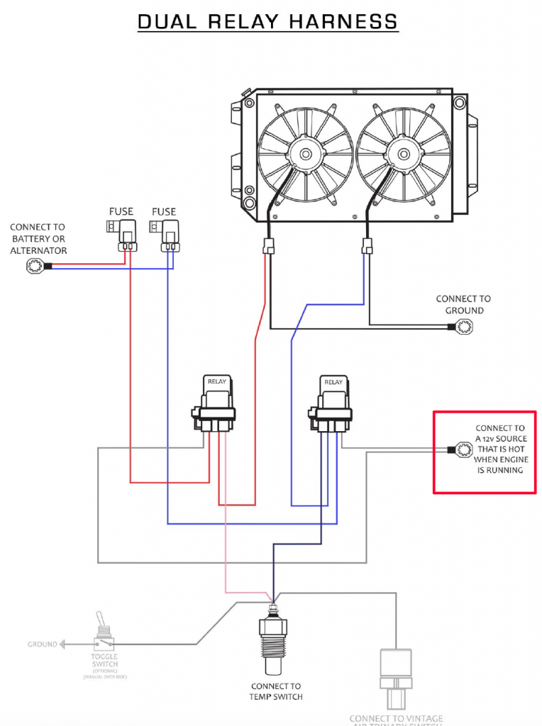

I have the whole harness with all the relays that came with the Entopy Radiator . I just have a set of wires that need to go to "power while running". (image attached.. Wire reference in the red Box)

A quick search online to locate a wiring diagram will take some of the mystery out of the adventure, and give you options on which wires are hot when Ignition is on.

What year is your truck? Going by your diagram you got you just need switch power which is not a lot so here is a option for you.
If you have a msd coil or super coil of any sorts run another wire from your battery to a relay and run it to your coil and use that wire that went to your coil for power to your 3 relays. It takes a lot of stress off the ignition switch running your coil off a relay then just the steering column switch. And the coil gets better power

It's a 74. I have an MSD Coil. This is an easy solution.. thanks
