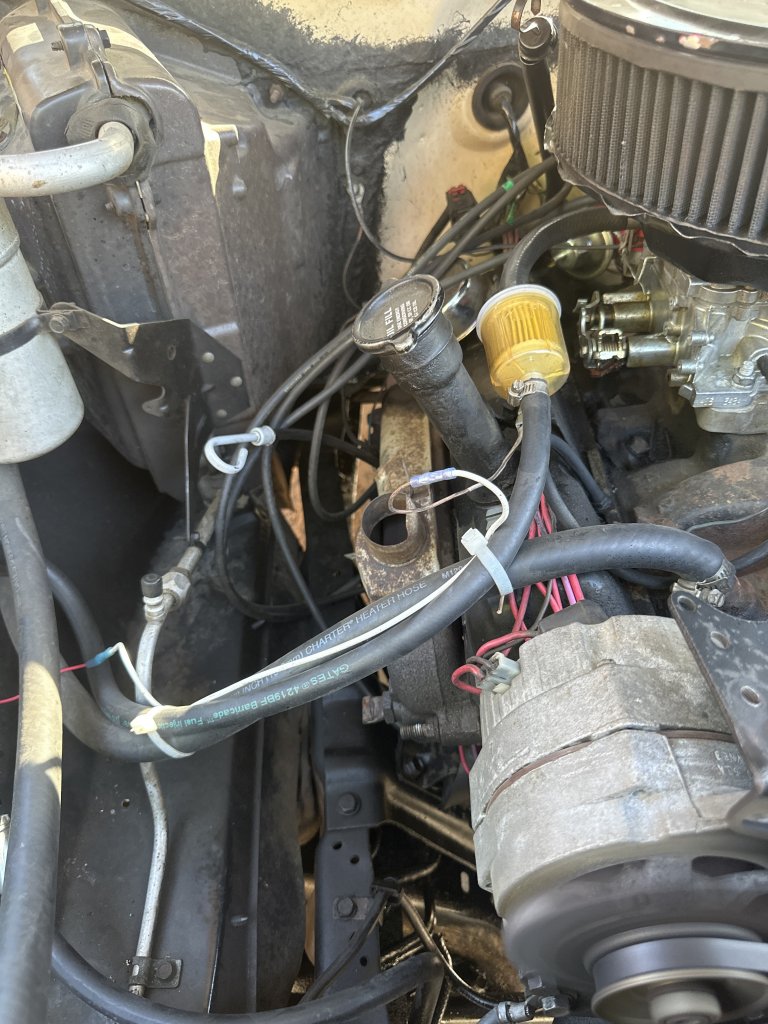

Hey so whenever I almost get home my electric fuel pump gets insanely loud making a thumping sound, and the fuel filter gets low is there any cause for this I will provide pictures and sometimes it will die because lack of fuel
