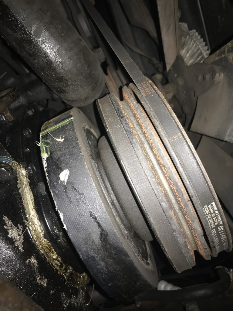

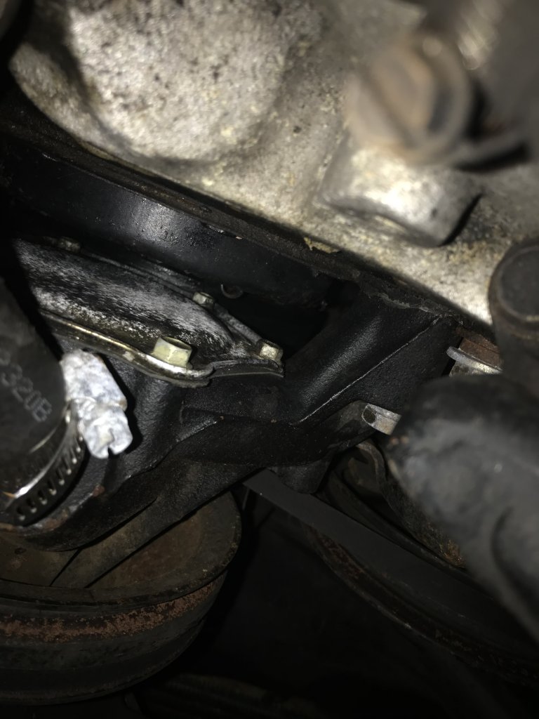

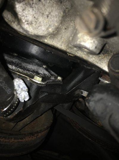

It’s hard to see, but the shiny part under the water pump is the back edge of the balancer. Plus the bottom view.

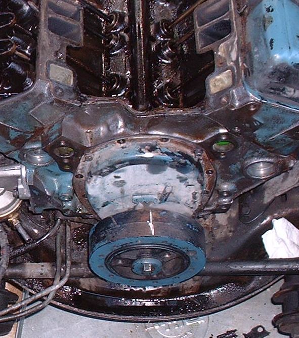

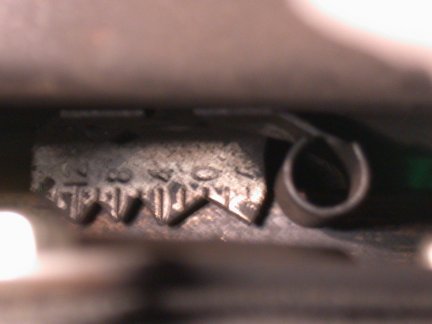

Not my pics. But, balancer is spaced out like the blue engine pic a my tab I calibrated like the other pic. Without the water pump everything is visible. Mines not. I will try to mark the line a little better.

I can see how your balancer looks stepped out a little but not too much. It's still under the marker. Is your crankshaft bolt tight?

My pics are the 3 above. The blue engine pics(not mine)are very similar. I would say my balancer is a bit further out. I don’t know when, but I’ll find time to work on it. I have my biggest food truck event of the year coming up. Super busy.

I was mainly talking about your pic of your balancer. Not blue engine
