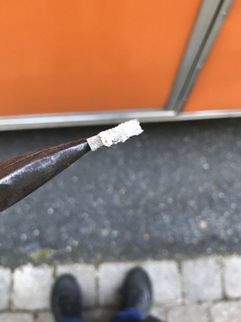

Got to work on the truck today. This carb needs zippers. Had it out two more times. Found the main issue. Under the needle and seats(there’s 2) are mess filters. One was clogged almost solid. The other almost as bad. I also took the distributor out and put it back on TDC for number one. Took it to get gas and it ran, but sputtered here and there. Filled the tank and it’s leaking from probably the sending unit. It’s not leaking in the driveway right now. I found my timing light and it was way advance. But I’m having issues seeing the timing mark. I’m going to get some white paint. Also, the starter never sounded good and is acting up with the timing changes.

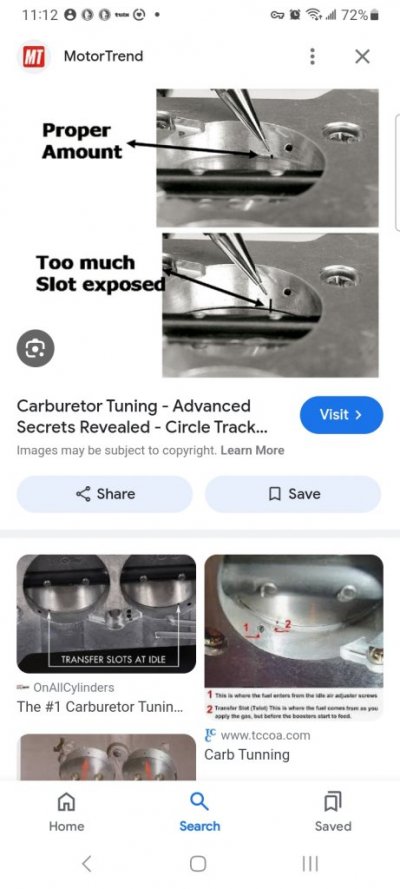

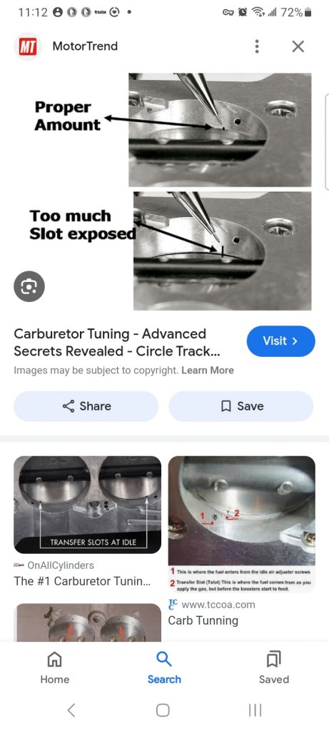

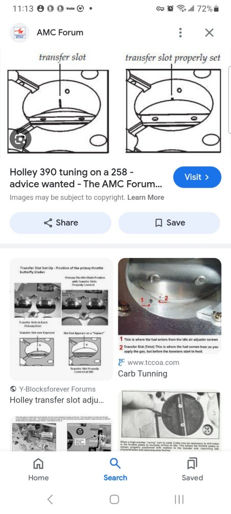

I didn't read everything,but if I had a stumble that I didn't have,before, accelerator pump working. I'd be looking real hard at my transition circuits. The transition circuit is just barely above the throttle plates and is to deliver fuel just as the throttle plates open,and they will cause a stumble like an accelerator pump. Lots of people crank the throttle stop screw in too far trying to make their cars idle and end up with a stumble because they are using their transition fuel to idle. I put that part in there for anyone who is using their transition fuel to idle. Found you a couple of pics of transfer slots,I always called it transition circuit. Anyway the pics will show you what I'm talking about if that circuit isn't clear it can cause a very annoying stumble.
