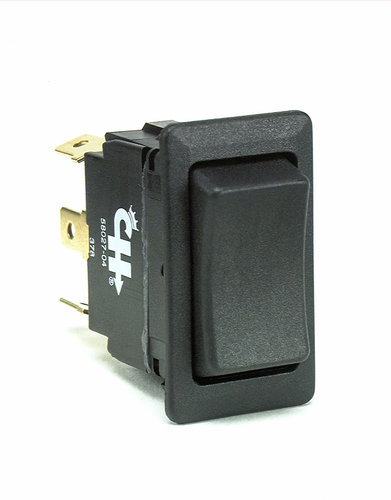

Cole Hersee - Dpdt Rocker Switch
Part # 58027-11
Line: CH
$11.99 @ O'Reilly's
•UPC: 632850354097
•25amp Dual Momentary
Detailed Description
•Momentary On - Off - Momentary On
•25A at 12V DC
•Weather-resistant, with gasket seal in the housing.
•Plastic housing, bezel and actuator.
•Silver contacts protect from arcing.
•Snap-in mounting to hole .838" (21.08mm) x 1.45" (36.83mm).
•Fits panels .093" through .187" thick.
•Six brass blade terminals:
•No.1 to Load.
•No.2 to Battery positive
•No.3 to Load.
•No.4 to Load.
•No.5 to Battery positive
•No.6 to Load.
•Also available in the same style with one or two pilot lights, dependent or independent.
Additional Details
•Switch Positions: Dual Momentary
SlickGTP
Feb 24, 2011
790
142
Houston, TX
Momentary switches won't work for a dual tank system... The auxiliary side of the tank selection solenoid needs a constant voltage against it to keep it switched. Otherwise, it'll flip right back to the primary side.
foamypirate
3,302
461
Central TX
Jake (Mr. Wilson)
El Camino, baby!
5.3L/4L60E
Only 87' and up (TBI) require constant voltage. The rest are all momentary, to the best of my knowledge. I learned that the hard way when I bought the wrong (momentary) switch for my 87' eons ago.
