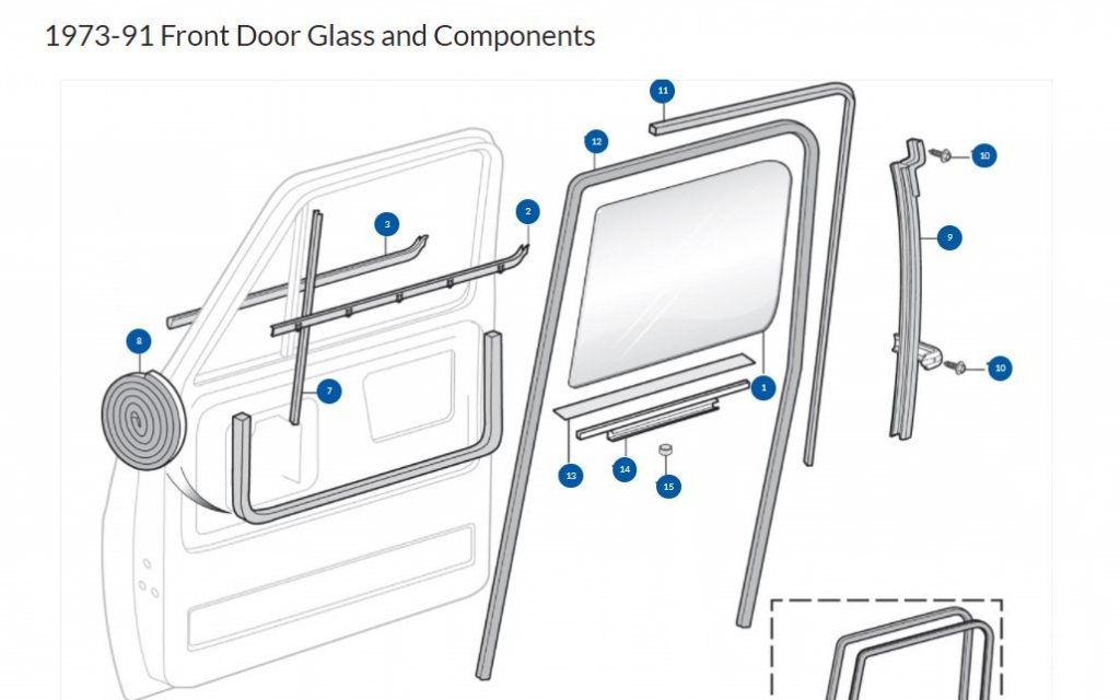

Reviving this thread as I'm having a similar issue. In adjusting the rear guide, are you referring to #9 in the diagram? It looks like the top is fixed but the bottom may provide forward/rearward adjustment via the slotted tab?
