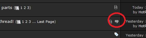

Also if you look at the list of threads and see an icon like the one I circled in red below, you are subscribed to it...
attachment.php
You can also click the thread tools drop-down menu at the top again and instead of saying "subscribe to this thread" it will say "unsubscribe from this thread".
