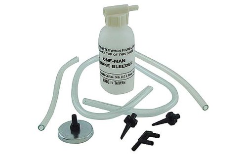

also got sucked into getting this..... the consept sounded great except the fact that your bleeder is cracked open and can still suck air by the threads........so you don't accomplish anything lol. unless im wrong, but the instructions say turn bleeder out one turn and on my new pistons i put in the bleeders were spotless and once cracked very loose threads.

I hate those things. Also Vac pumps for bleeding. I can do it, but I still feel you get a better job with the old fashioned pump it and hold it method.

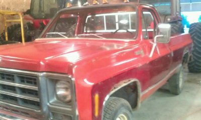

wow wat a little wax can do.

IF you have to, you can use the same drums for awhile, but I'd make it short as possible. And when you have have the cash or find some cheap used ones, you might have to replace the pads again if you can't sand them smooth after the drum replacement. More importantly, is getting you some brake pedal. As long as long as the wheel cylinders aren't leaking now, just do what you gotta do. Also, did you by chance replace the axle seals. Hard to tell in the pic, but that could have also been gear oil from the axle tubes.
Seems to me that old red faded squares revive well with some elbow grease and junk out of a bottle.
