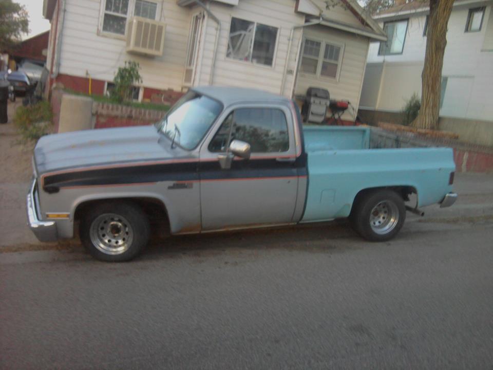

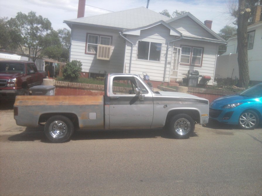

my 85 low rider has 56'' springs it rides worse than the 52'' ones did on its old chassis.
I done a frame swap on it
it use to have 52'' springs with drop brackets and shackles to drop the rear it rode awesome I loved it
the new chassis has 56'' springs and an axle flip and the shock brackets dropped 4''
it rides harder than it did before with the drop brackets and shackles
I am not sure its the springs it might be the difference in the shocks or something with the axle flip causing it to ride worse
the pic with the baby blue bed has the 52'' springs and drop brackets and shackles the other pic is the 56'' and axle flip
