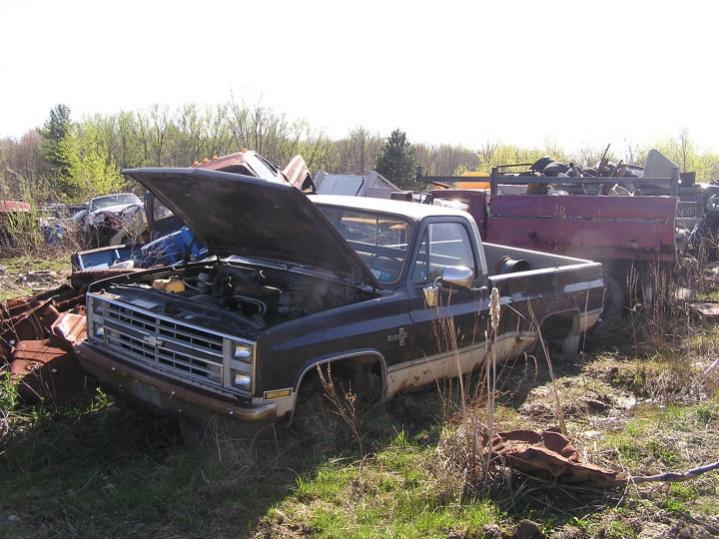

Hey guys, im getting my interior finished and im confused. its a 85 cab. silverado cab. did all cabs come with the center dash speaker?? Because i can not find the wire for the center speaker.
Can someone please post a pic of what the plug should look like for the center speaker??? If my cab has one.
this is a pic of the cab i bought! this is not my truck i just bough the cab. Maybe the pic will help you guys answer my question

That looks like a Silverado trim level, it should have the speakers in each corner. All trucks had the center opening whether there was a speaker there or not.
