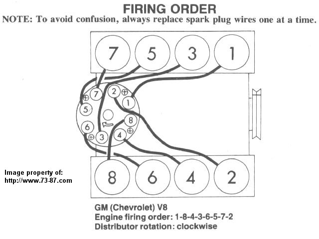

Can you help me to find the diagram of the firing order for an 87 gmc 350 tbi thanks

here you go
