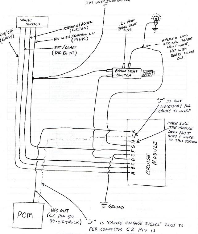

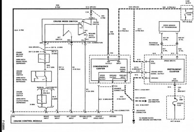

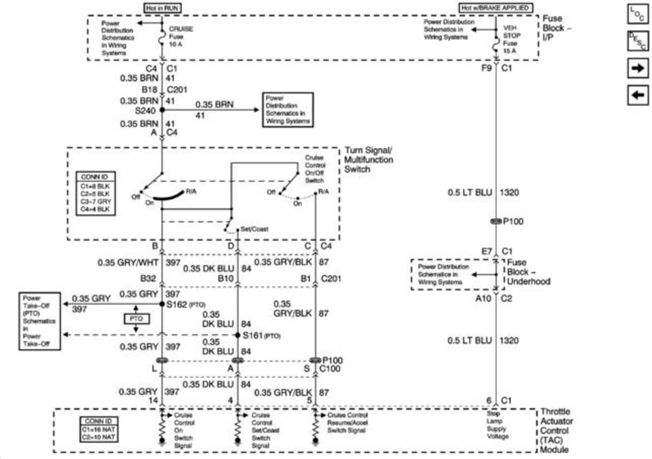

I need some help with wiring the factory 86 K10 cruise control wiring to the 04 LQ4 DBW wiring for cruise. I need to know how to wire the 86 K10 wiring column switch to the DBW TAC wiring for cruise. Thanks
