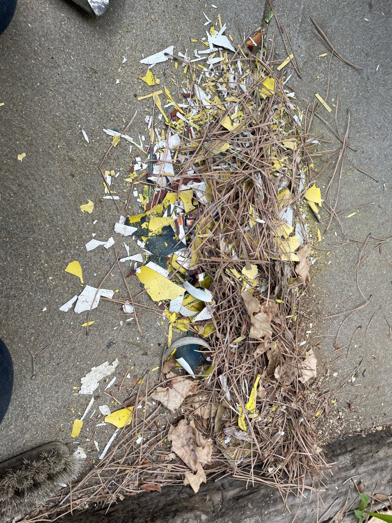

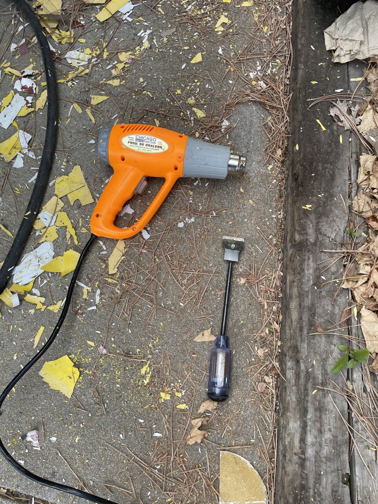

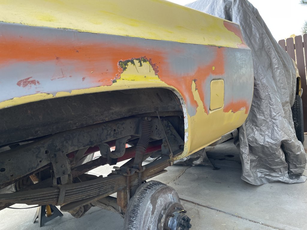

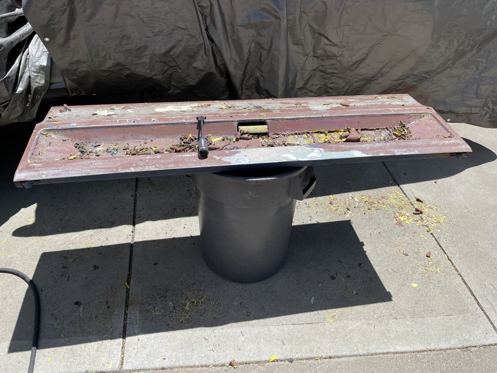

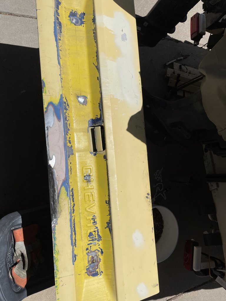

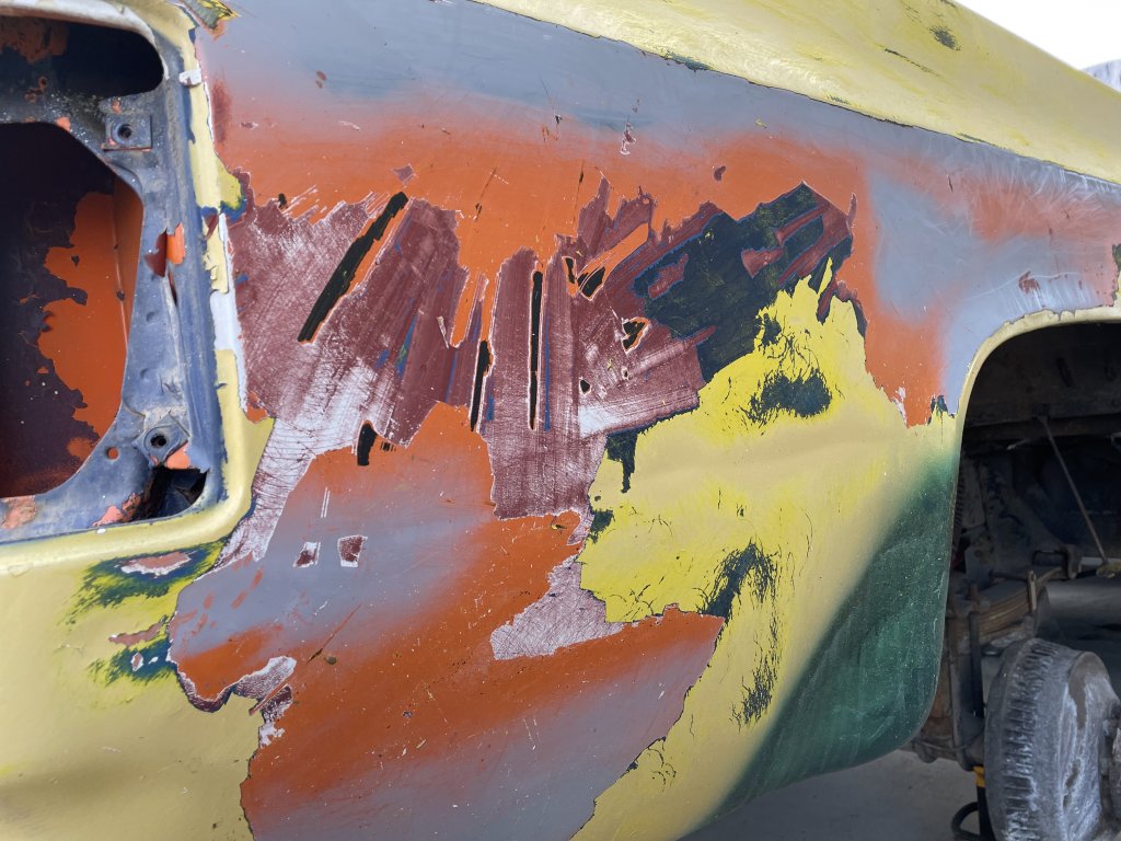

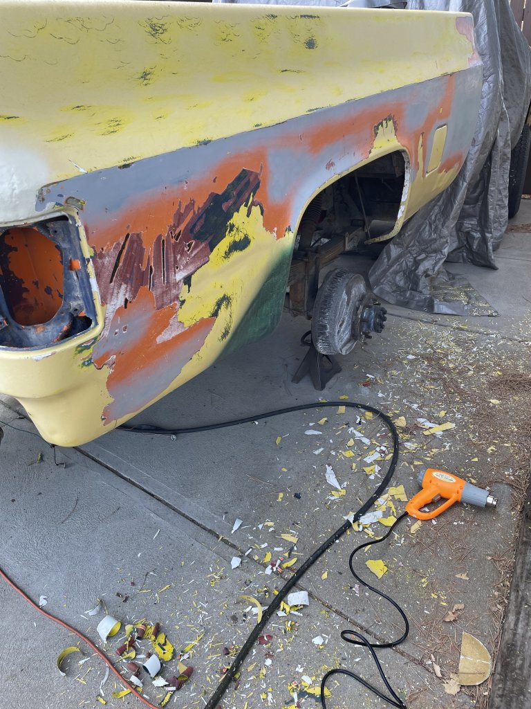

I despise sanding, already had to replace the compressor electric motor. I decided to try the harbor freight heat gun. Not sure if it’s because of the solar eclipse, the air temp, luck or all three but the 5 extra layers for the most part is scraping off fairly clean with some heat AND it’s so much easier and cleaner than sanding. Plus, my compressor should last a lot longer. I hope the rest of the panels go this well. I did this much in about 2 hours.
