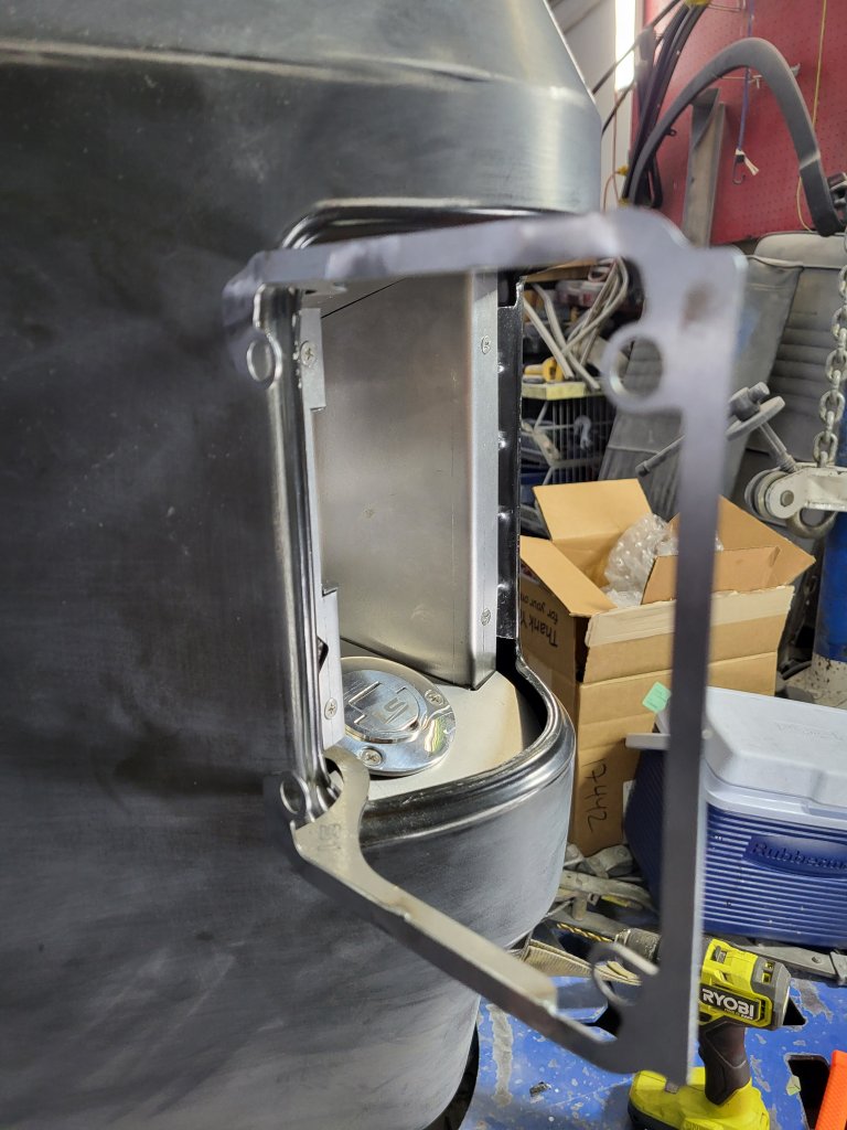

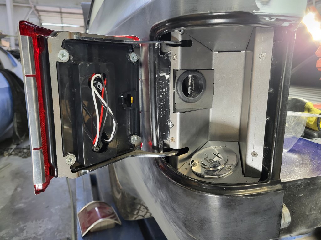

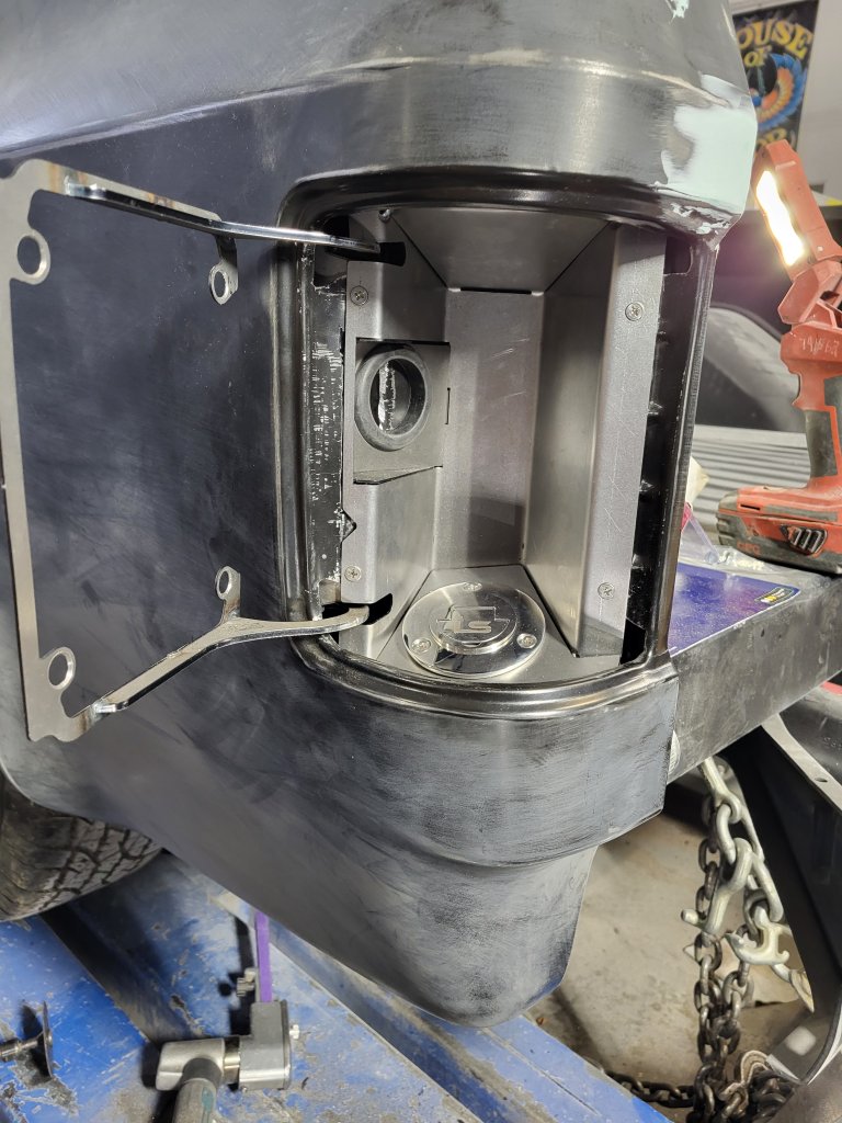

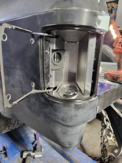

I'm installing a square, center-mount fuel tank from Tanks, Inc. i.e. 1973-81 Chevy Blazer Fuel Injection Gas Tank. The tank has a pretty standard EFI fuel pump, and this fuel neck, which came with the tank, but strangely they don't sell on their website: 6 Hole 90 Degree 1-5/8" OD Bolt On Filler Neck w/ 5/8" Vent, Part Number: FN15B.
Terminating the filler hose at the inlet end is a custom billet filler neck that came with the (1973-87) Hidden Tail Light Fuel Filler Kit.
This 1-1/2 inch outside diameter fitting has no vent tube fitting incorporated. And even though Tanks Inc. sells a gaggle of hoses, necks, and couplers, there's not a single fitting that will connect two 1-5/8 inch (or 1-1/2 inch) hoses that has an integrated 90° fitting for a 5/8 inch vent line.
Our plan, from tank to filler neck, is to plug a 1-5/8 inch (or 1-1/2 inch) filler hose and 5/8 inch vent hose onto the tank fitting, run those up to a coupler that has an outside diameter of 1-5/8 inches (or 1-1/2 inches), and incorporates a 90°, 5/8 inch fitting for the vent line, and then use a small piece of 1-5/8 to 1-1/2 inch reducing hose (or just 1-1/2 inch hose) to connect the coupler to the filler neck.
We can use all 1-1/2 inch hoses and fittings and just warm up the hose and jam it onto the 1-5/8 inch fitting at the tank, or we can do the reducing system I described above.
Our problem is that no one on the planet makes a 1-5/8 inch (or 1-1/2 inch) outside diameter coupler with a 90° 5/8 inch integrated vent line fitting. How do we solve this? Has no one else ever had this problem in the last hundred years? Certainly we can't be the first ones?
