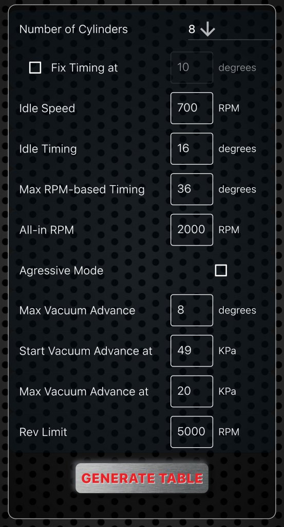

I didn’t have to do much to get it going. Right off the bat it will generate a base timing table for you with a conservative advance, a ‘safe’ table. You can generate as many new tables as you want and for each one you’ll be able to input your own specs. See the attached pic.
I played with the max RPM based timing to see how much advance I could give it. 36° for max works well for my 454. I pushed it to 38° without it pinging, but I didn’t feel any gains so left it at 36°. I also played with the ‘all in’ RPM. Stock distributors have to reach about 3000 RPM before all your timing is ‘all in’. I set my Progression distributor to be all in at 2000 RPM so it starts advancing much faster as soon as you come off idle, but still maxs out at 36° total. That really woke up the engine and gave me a lot of power that was being left on the table with a stock distributor. Stock ones are very conservative.

Thanks for the insight! So, just so I understand it correctly, you have it set for 36° max RPM based, and max vacuum @ 8°. So at all in (2000 RPM), are you at 36° or 44°?

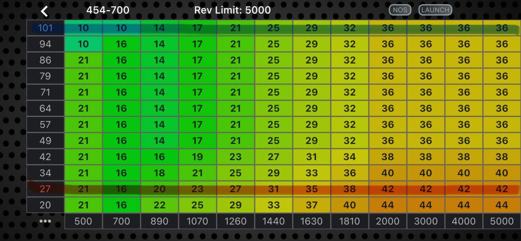

Yes. It only hits 44° when vacuum is extremely high, which is on deceleration. Once you give it throttle and the vacuum decreases the timing drops and returns to 36°.
The red highlighted row near the bottom is idle vacuum. The very bottom row is higher vacuum than idle and you can see it only hits 44° at high vacuum high RPM on the bottom right. Top row highlighted in blue is atmospheric pressure, zero vacuum WOT. As you go from bottom to top you can see the advance back off as it gradually goes back to 36° the more you get on the throttle.
