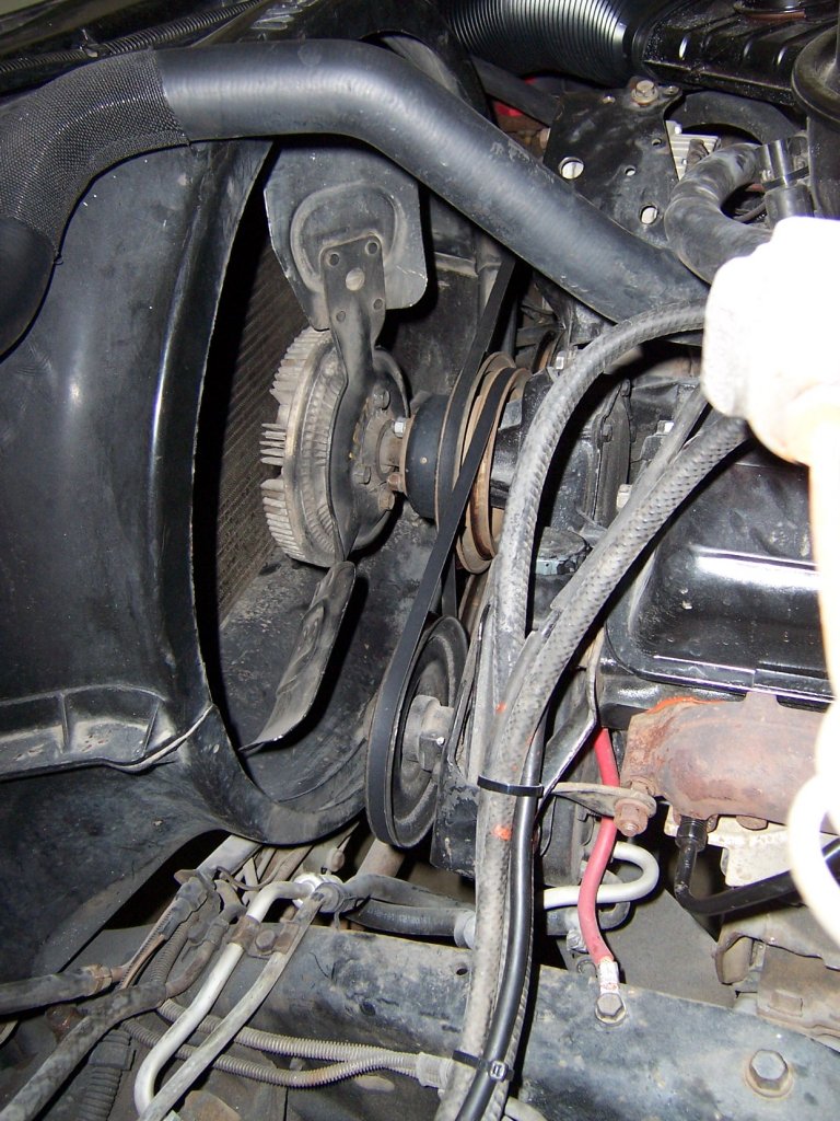

Keep in mind depending on the clutch the fan may be noisy at times. I took off a 5 blade and installed a 3 blade to quiet it down. Drove the truck 200k towing cars all over the county in all weather. It never overheated. Would not recommend doing that with an AC equipped truck.

I have both those fans on different trucks. The bottom one is noisy especially at start up and when first entering freeway speeds.
