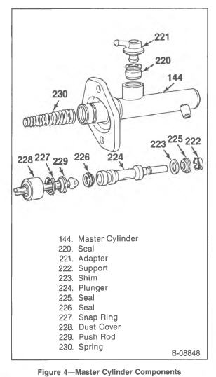

Is the cylinder off the truck?
Georgeb
Apr 30, 2015
3,259
214
Wisconsin
George
2003
K10 Burb Z71

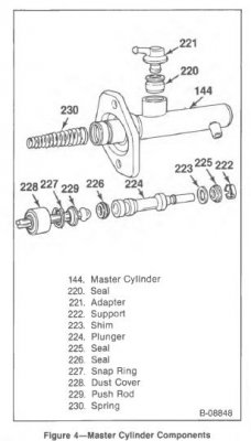

I believe the snap ring number 227 is holding it in.
