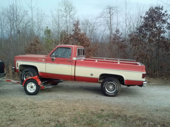

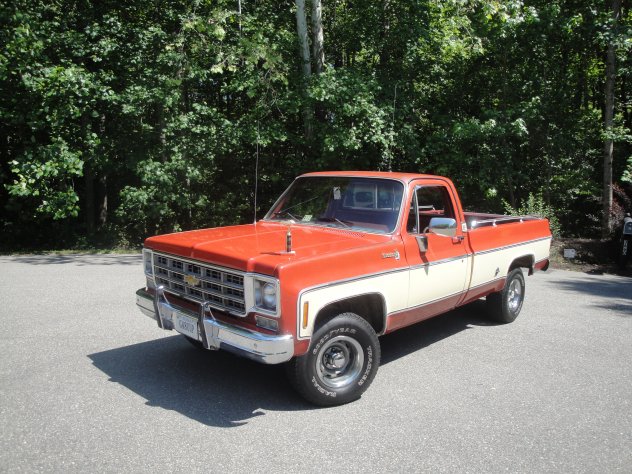

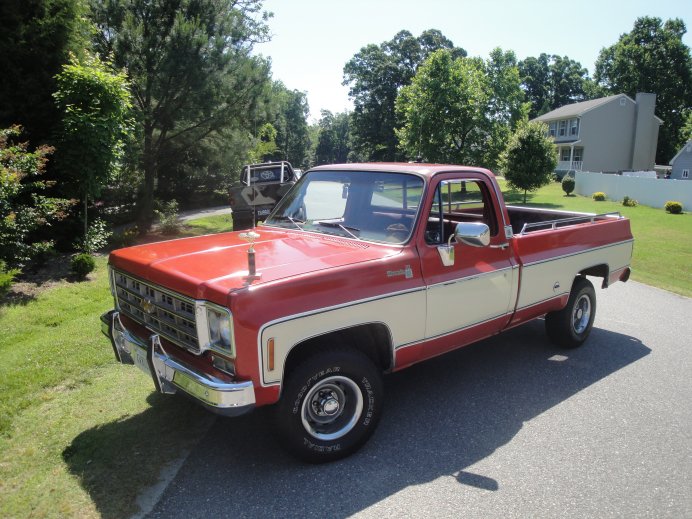

on my truck i used meguiares diamond cut compond and putting show car glaze on top then waxing. did wonders! but it takes a bit of time and elbow grease! oh and you have to wash your truck first for the best results! heres some pictures of before and after. hope this helps

and this stuff can get out surface rust, dirt or whatever else is stuck in the paint! forgot to add that haha
