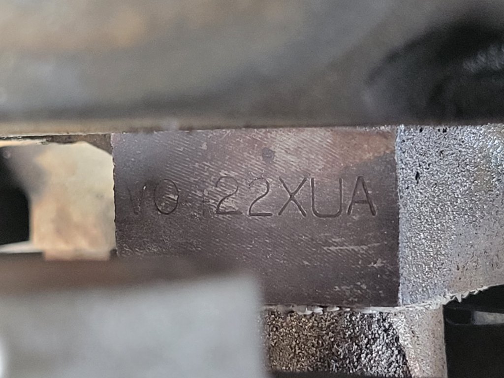

Hey guys new here been slowly working on an 87 r10 that had a motor swap at one time. The engine suffix is v0122 xua any thoughts? I haven't had time to get to the casting number yet it's kinda hard to get to lol.

That suffix code isn't in the lime book. Is it a small block? Big Block? You are likely going to need a block casting number and casting date as well as the cylinder head casting numbers to make any determination of what you have. Pics are also helpful.

Suffix code

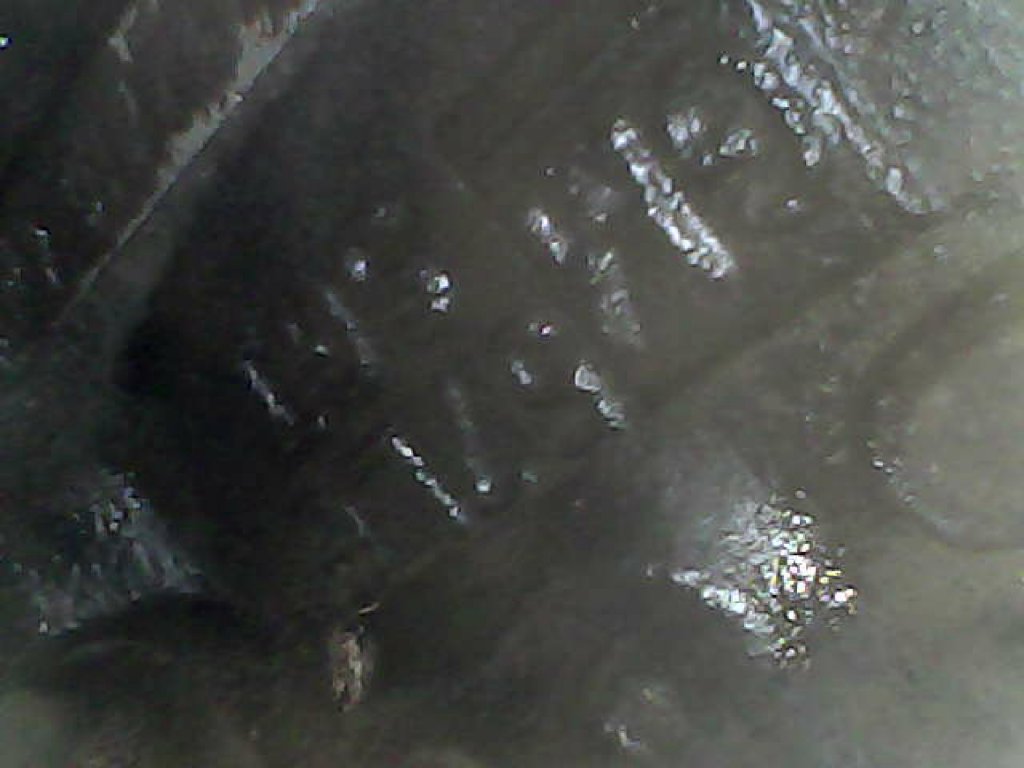

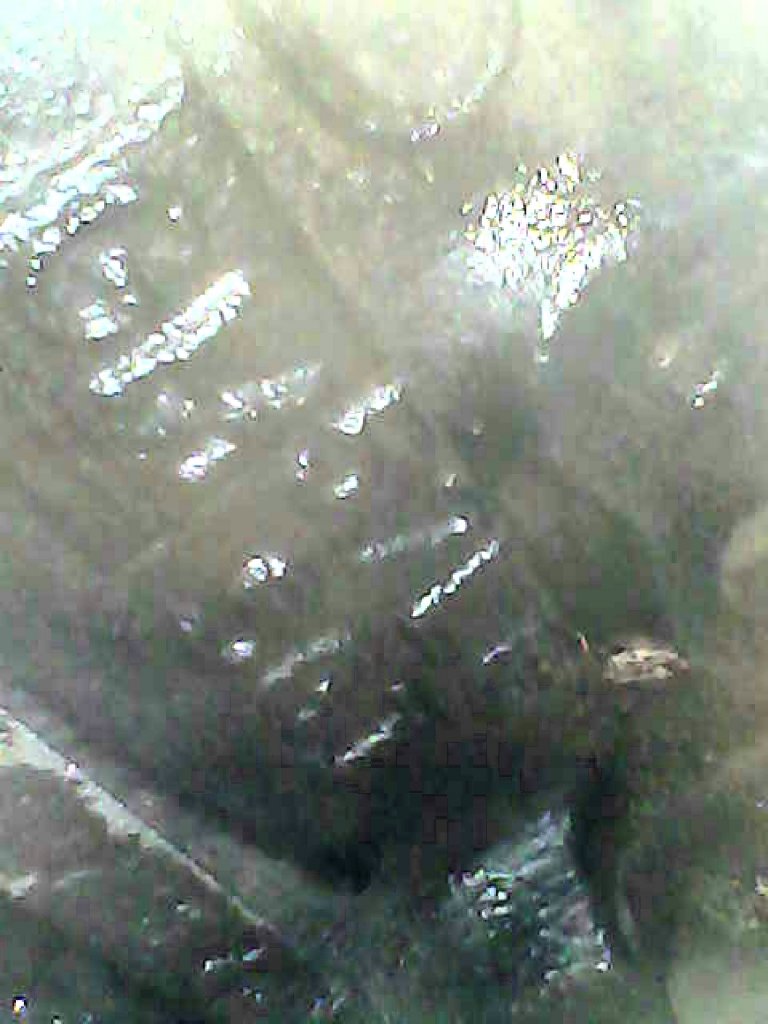

I can make out gm 57L and SGI is there another place for the casting numbers?

As I said the only thing on the back right is the 5.7 stamp 5.7lg sgi. This is currently being driven daily I was just hoping to know if it was worth building. I was informed that the suffix is for gm replacement engines. But when I rip out the motor and refresh it I'll let you know what I find.

It's not a stamped number it's a raised number casted in the block.
