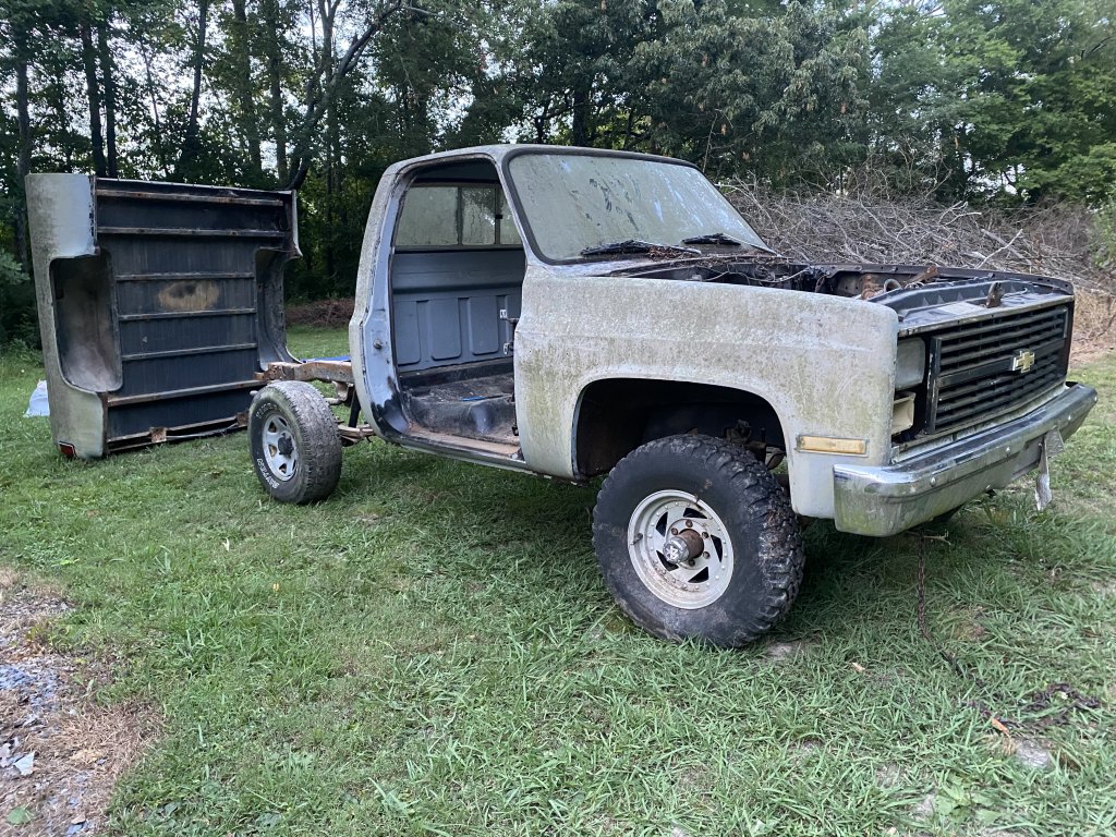

I’m restoring my first truck, a 1984 Chevy Custom Deluxe 1/2 ton 4wd. Was a complete roller so I was looking at getting a transmission and transfer case. I believe this truck originally had a np208. I have found a th350 w/ a np203 for a relatively fair price. I was just wondering if this would even work for my truck, I’m aware that I might have to put the conversion kit and lockers but was just curious if this application would even work. Or if I just need to find a 208. Thank you
