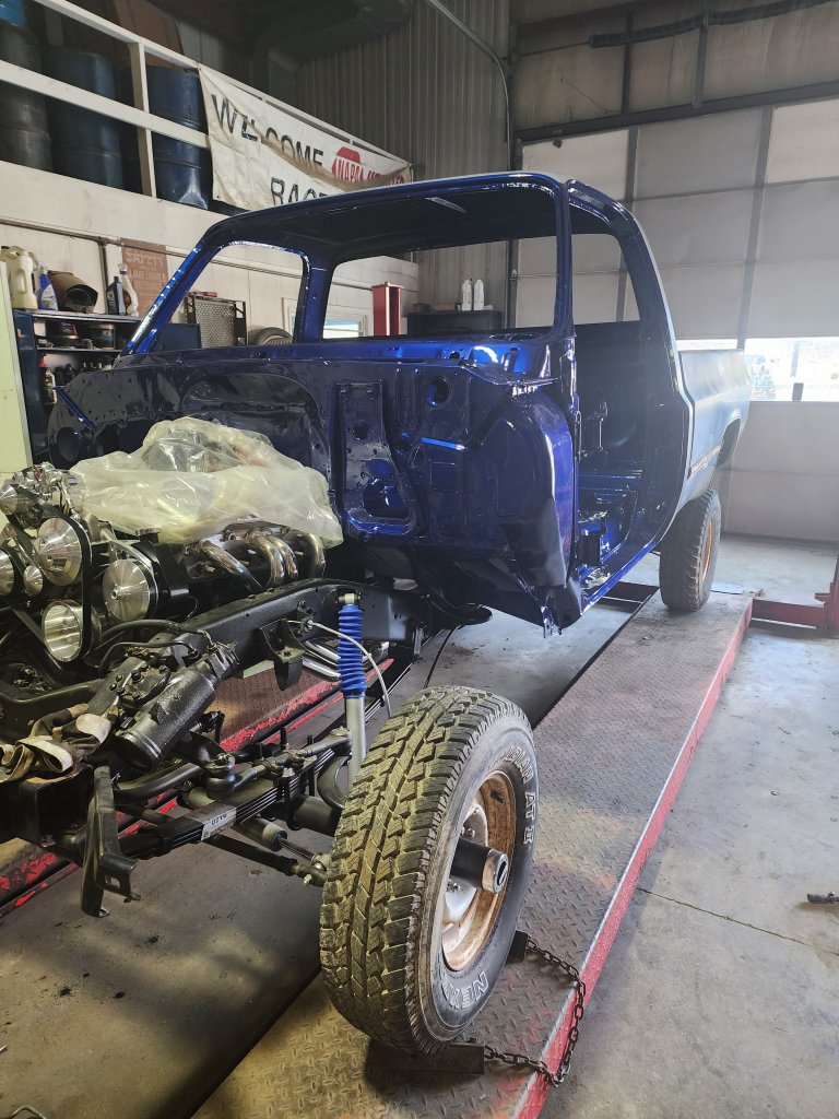

Im doing a frame off complete bolt resto on a 86 k10 the firewall was trash so I knew a guy with a cab and swore it would fit. Its a 88, 1 ton, 2wd, he claimed it would work with a 4wd on the half ton. The problem is the center floor hump but he said it was a 1 ton and would work but if it where a half ton 2wd will not work. Can anyone confirm that it will work or am I out $$?

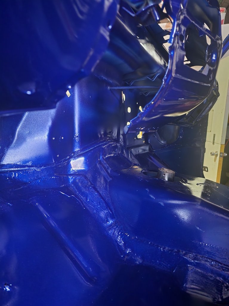

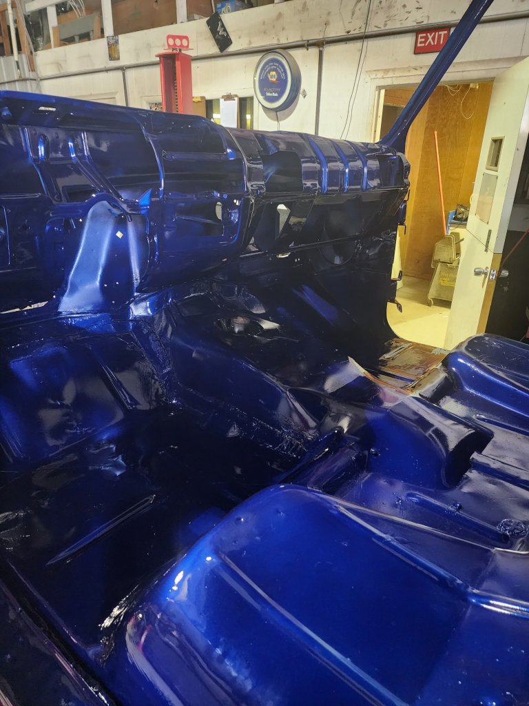

Update: The 88 1tom 2wd cab fit perfect, all I have to do is cut the hole for 4x4 shifter.
