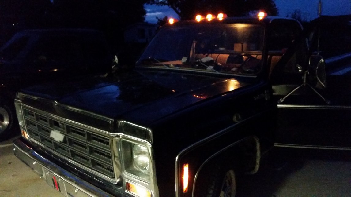

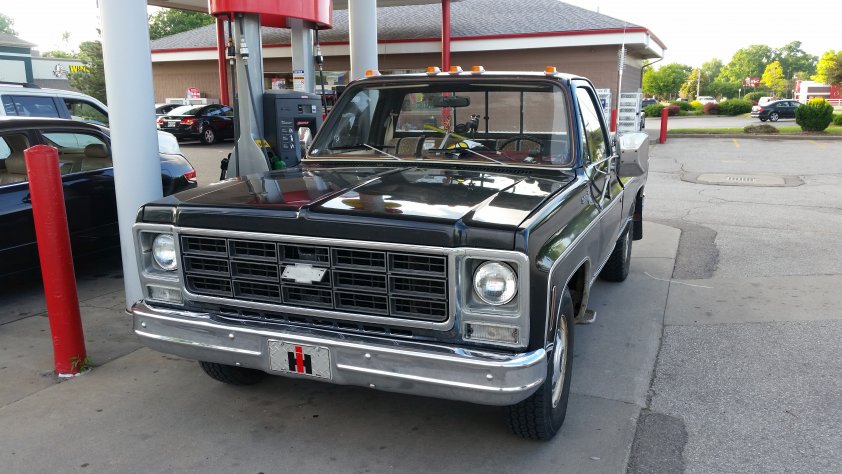

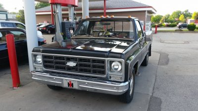

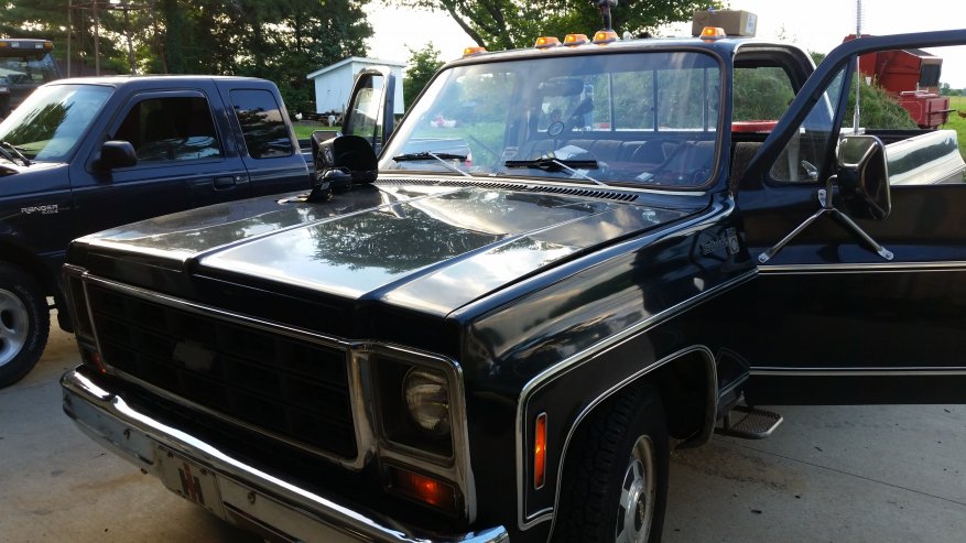

Hey folks,
I had to finish some other projects first (Central IN has been getting POUNDED with rain), but I got the lights on!
Big thanks to chengny for the photos. I ended up removing the dash panel and working through a rectangular hole in the sheet metal to the left of the headlight switch. Those really helped, hopefully other people who want to install cab lights will find that helpful.
Somewhere on another forum, they talked about wiring the lights. There is a contact on the headlight switch specifically for the cab lights. Its to the left all the way at the top if you are looking at the contacts on the switch with the knob on the left hand side.
Anyway enough talking, here are some pictures.
