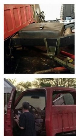

I seen a picture on the internet on a k10/20 with a burban(blazer)? gas tank mounted between the frame rails. I know many people have mounted them to the real area, but id like to hang the spare tire there eventually. it was mounted between the frame rails, a few inches to the rear of the cab, above the driveshaft and underneath the bed. Im thinking that with this configuration, I can have a bigger tank, eliminate the tank from hanging below the body line and be able to fill from the stock location. has anybody ever tried this or know where i can find some more information.

It would be ideal for handling characteristics/center of gravity as well as the ability to use stock location fillers. Heck you could even use dual fills if you wanted.
The question is how to safely install in said area due to the possibility of the drive shaft breaking ?

this is the picture i found...

That location would only work I think if you had a body lift on the truck to get the bed up and away from the tank and as Ogre said.. I wouldn't want it there in case the drive shaft separated.
Sometimes what thinks or looks like a good idea really isn't. The one reason I don't necessarily like the tank at the back of the truck for is the weight distribution. I would like to see what the weight differential is between the front and rear of a truck that has the tank at the back.
