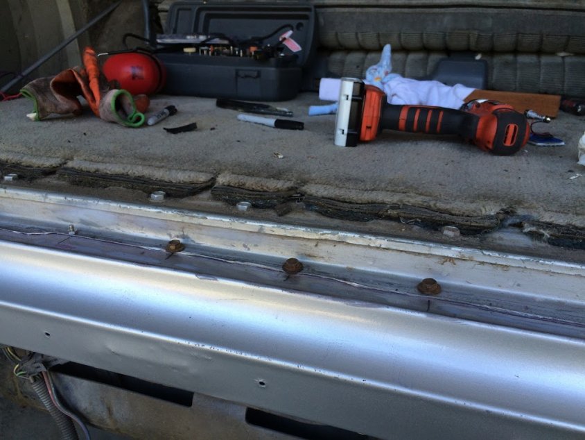

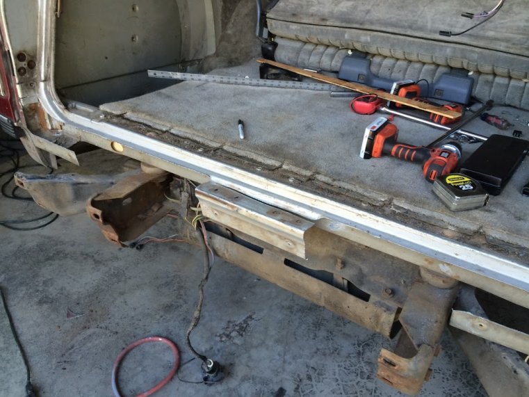

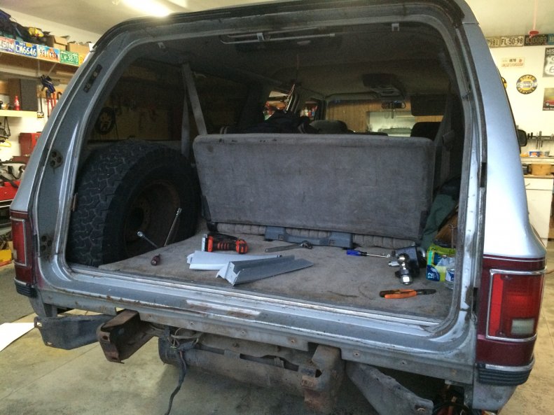

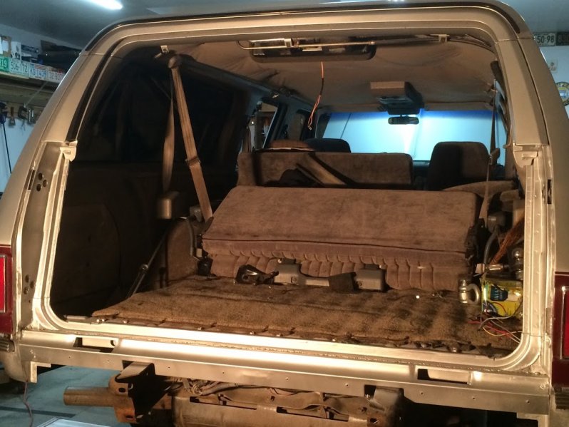

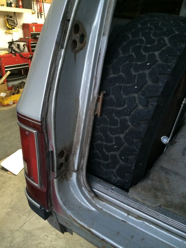

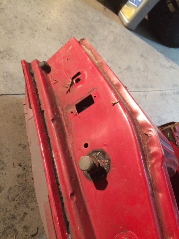

Well, I've finally made some progress on the project. I've decided that instead of replacing the entire rear cross member/tail gate support, I'm going to modify the existing cross member. This involves two operations: 1) reinforcing the areas where the tailgate hinges bolt up and 2) cutting out part of the existing sill plate and then mating the tailgate sill plate in its place. This is necessary since the tailgate sill plate has a large concave fillet to allow clearance for the gate. It also has rectangular holes for the hinges. Take a look at my album so far - it should explain what I'm doing for both. This weekend hoping to get the tailgate primed. I'll add more pics as I do the work! Advice and suggestions welcome! Thanks.
