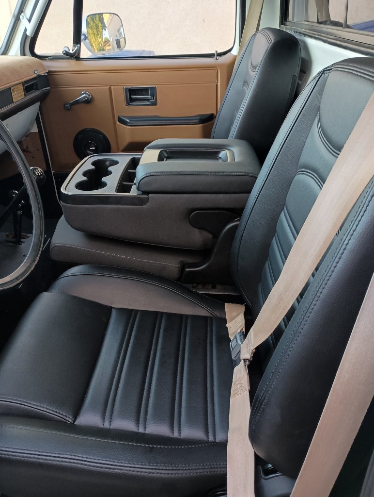

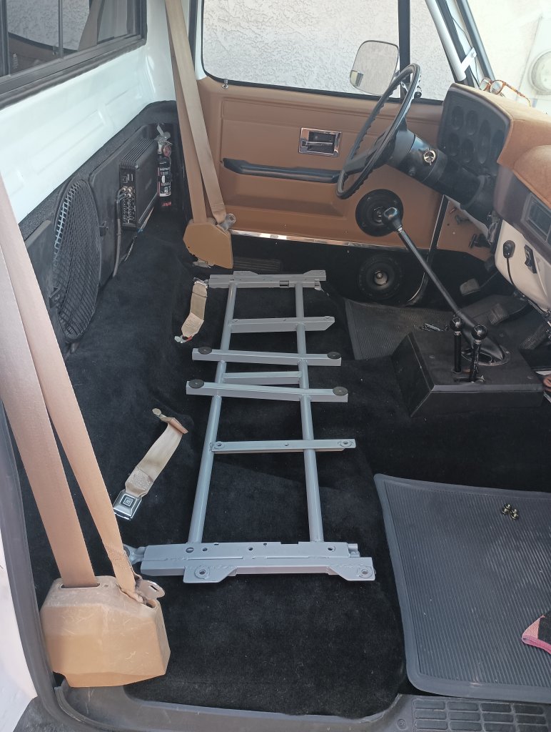

Or if your a glutton for punishment you can make your own.
