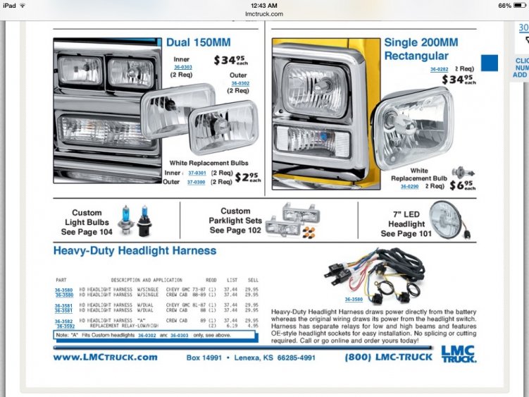

I bought these lights and the harness. Installed them Saturday, Works good so far. See a lot better too.
I had some diodes and tapped into the hi and low beam relays on my duramax. Made the dim lights stay on when switching on the brights. That was years ago. May try it on this truck too
