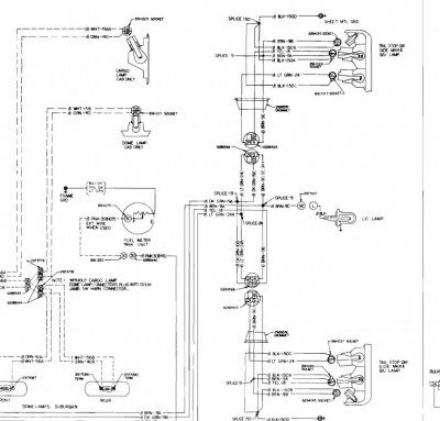

The wiring diagram for your 83 rear end lighting groups:

on that diagram, the PO tapped into the wiring after the 4 prong plug that goes to the driver tail light. I won't ever use it so I am going to try and undo it all. I hope that is where the foul up is. Doesn't explain why the passenger B/U light illuminates when the left turn signal is put on.
Do you think it could be in the headlight switch or inside the column??? Hope not.
