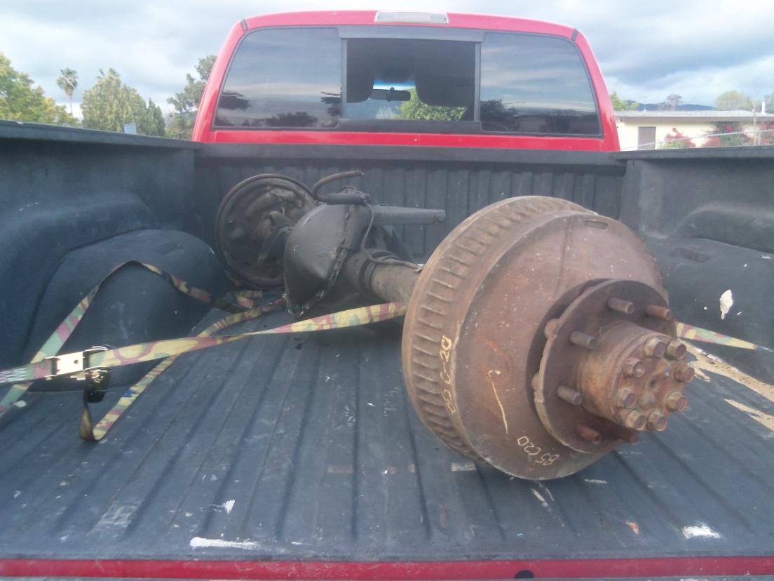

I think u need one of these,,,,,,,I just picked this one up today 4.10 gears,,,,:happy107:

If there's a possibilty of running 35's + some light towing I'd go with 4:10's. I have them and never feel like I should be running something else, whether it's running solo or pulling the boat. The variable is I have a Th400 trans, not a stick, and I don't know what the difference is between the final drive ratios. Another factor is I cruise the highways at 65 max. Mine gets bad enough mpg as it is without tryng to drive 75.
Do you know what gears were in there?
