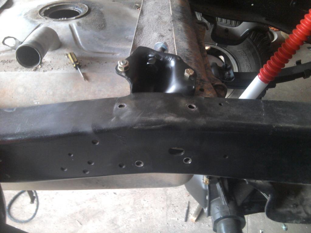

kleedus
Jan 25, 2012
1,726
164
wyo
Ray
1960 threw 91
c10 to k30
350 threw 454
k 30 how are you going to adress the right shock mount
on mine the mount had to be moved
1986K30
Oct 3, 2012
32
Colorado
Sam
7.4L
Kleedus - Thought that may be a problem but I have not had time to test fit anything yet. I'll probably just have to remove it and build a new center mounted cross bar for the shocks.
