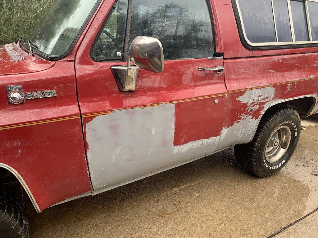

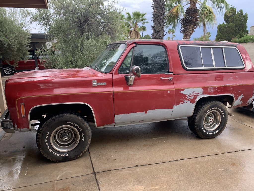

I've used CitriStrip to remove grey primer that was painted over the original red pain on my Blazer. After trying several techniques, this was by far the best and most efficient. Pour some in a metal bowl. Use a paint brush to put it on. Be liberal but not too sloppy. Let sit until it "curdles" the paint. Then wipe off with a rag or a power tool of some form.
Do test on a small corner before you do this. If it sits too long it can get into the bottom layer of paint. When done use a hose to spray down to stop the reaction.
Best of Luck!!

That's quite impressive, I'll have to try this on my Suburban. I don't even care if it hurts whatever ugly paint/bondo/rust is underneath, I'm just tired of the blotchy gray primer and wasn't looking forward to sanding it off and gumming up the sandpaper.

Yeah, guess I didn't consider that the paint may degrade real easy with something that wouldn't instantly eat the old paint under it as well. Of course, it's never the paint you want to fall of that doesn't stick....but any of those above products and a pressure washer may do the trick with less wax on wax off.
