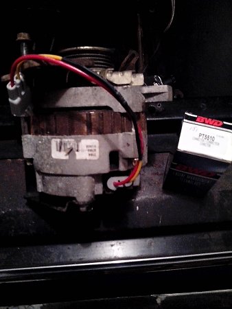

Great alternators don't have to cost a ton. Pick up that pigtail thingy for 18 bucks, plug it into a mid80s 105amp Corvette alternator, change the pulleys and call it good for a Ben. Bolt in, direct swap... It's that easy.
