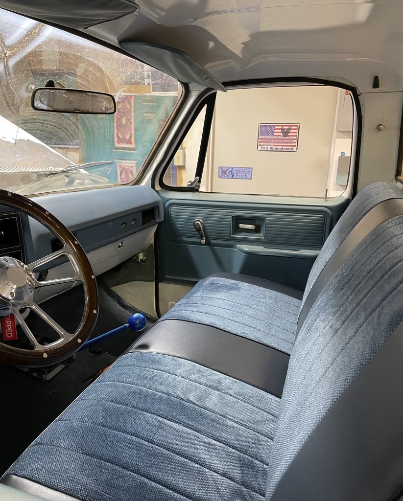

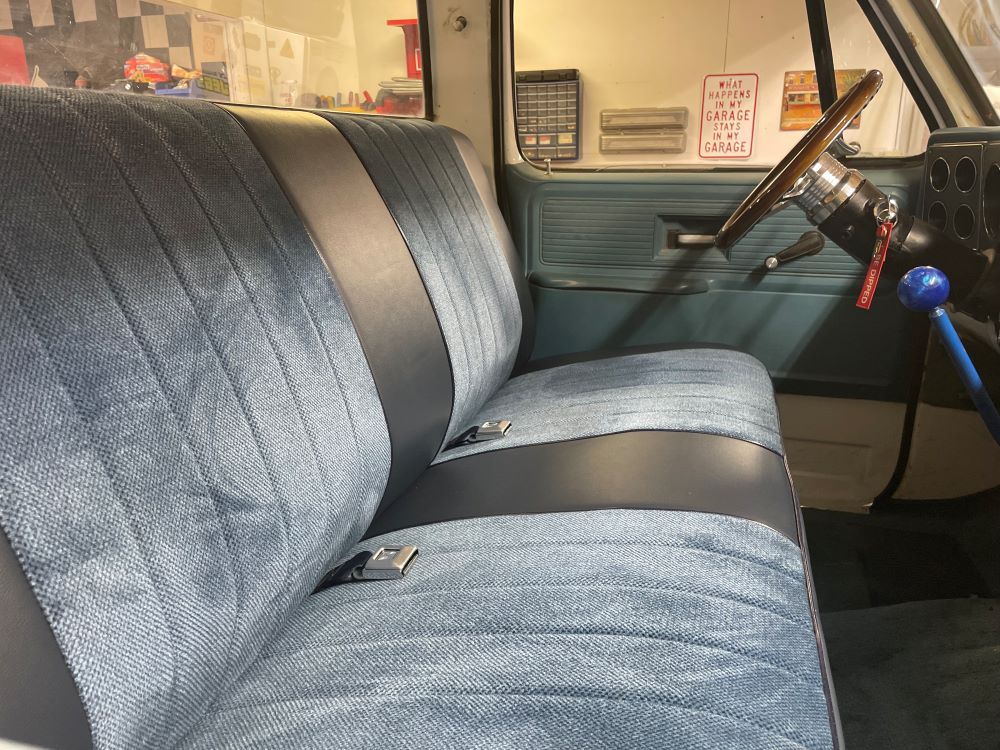

Emily.. at B62 Upholstery did my bench seat, Good quality but not cheap! You get what you pay for.
