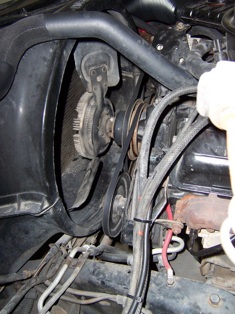

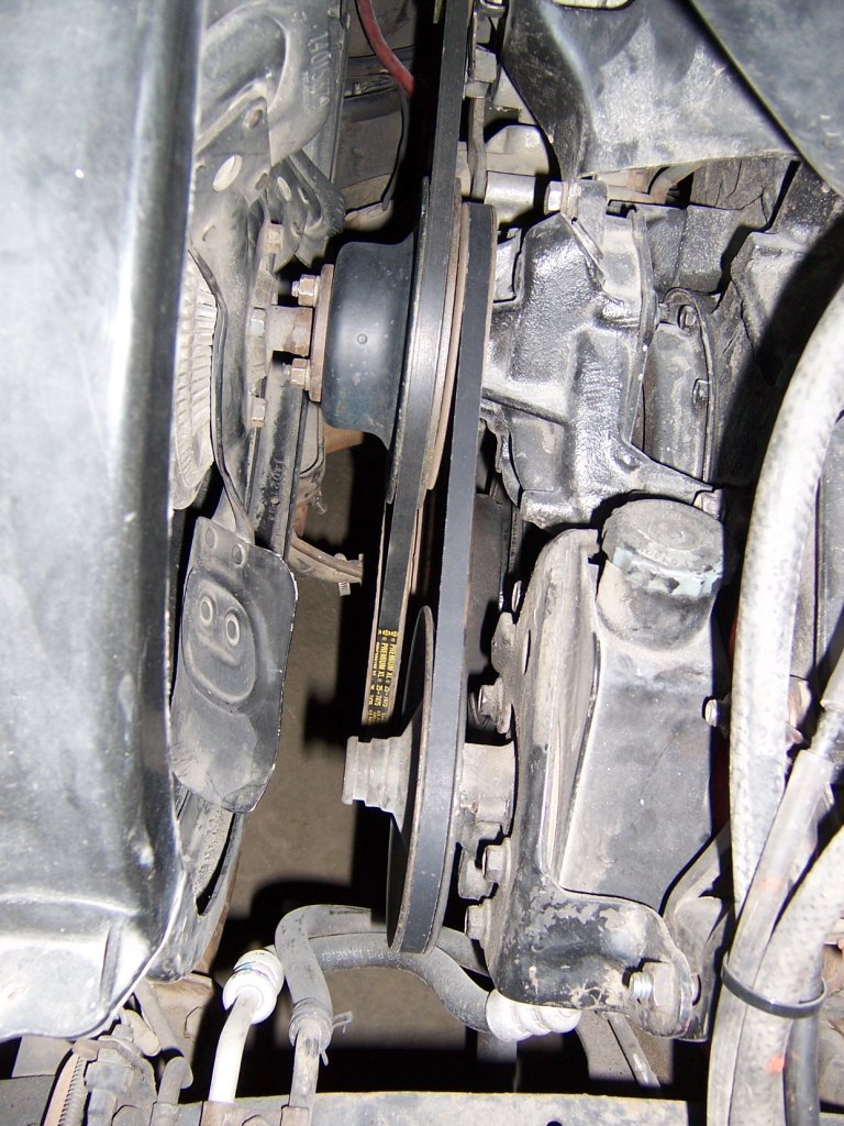

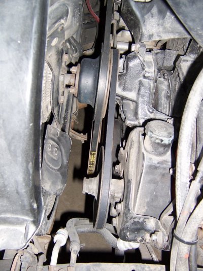

I have been working on the burb and have an issue. Wanted to replace the belts. I bought the same belts that were on it when I bought it....but none of the 3 belts are actually listed as belts for this truck. I have a 77 350 5.7 with the 3 belts. But considering it was running great and quiet I bought the same belts to replace with. Everything is working, but I now have a squeak/chirp coming. Can't find definitive information on which belts I need. I am not even sure if my belt routing is correct. It is just what was on it when I bought it. I have also noticed the accessory drive pulley with 3 belt spots isn't spinning straight. Has a little wobble to it. Can't seem to find that pulley anywhere. Harmonic balancer is spinning straight and true, but that pulley mounted to the front of it has a wobble. Seems like that could be causing my chirp.
Current routing is:
Belt 1 - AC, Power Steering, Crank
Belt 2 - Power Steering, Waterpump/Fan, Crank
Belt 3 - Alternator, Waterpump/Fan, Crank
Here are a couple pics for reference.
Trying to find what belts and routing I should be running, and if anyone knows where to get that pulley from? Appreciate any help.

Belts should be just a hair above or even with the pulley and have no more than 1/4" stretch/slack.
IIWM, I'd check the bolts on the bottom pulley before going to the dealer to buy a new bottom pulley.

Belts appear to have been sprayed with dressing? If so, all the belts will have to be replaced, pulleys cleaned.
A bent pully will also cause noise sooner or later. Get the part number off the pulley, do an internet search. GM probably made a million of them.

Pulled the pulley off, and it was a little wonky looking. Like the back of it has just a slight warp to it. I am going to replace it. But the problem is, I can't find it. It has 3 grooves, but 1 is larger than the other 2. I can find one that has 3 identical grooves new, but the one with 1 larger groove doesn't look like is made anymore. Can get a used one on eBay, and there are a few online people that have them old stock, but a longer wait. So I think I will replace it with the 3 identical grooves and adjust the belt size. While I am there, I couldn't tell if the harmonic balancer was contributing to the wobble, so I am gonna replace that too....so I pulled that off as well. Looks to be a very old one, so it is a little preventative maintenance anyways.

Just had an epiphany. The 2 groves on the crank are different diameters. Those 2 belts are running on a single sized water pump pully. So, in other words, the crank is turning the belts at different speeds on water pump pully. One belt has to slip.
You are totally right. Wow, I feel so dumb now. It's obvious, but I just never caught it.
When I picked her up, only one of the belts was on the water pump. The alternator belt went up there. But the power steering belt was shorter and didn't go up there. I wondered why it had an empty groove on it. When I put new belts on I bought a longer one to make sure it routed up there. That was my problem. I am wondering if someone put a different pulley on the crank at some point. Or did it come from the factory with an empty groove on the water pump pulley? Either way, I am getting the new pulley that has all of three grooves the same size. So that should take care of that issue right? I would prefer to have all the grooves in all the pulleys being used like they should. Just looks weird under there when it isn't. If they are all the same size that should eliminate that part of the problem.

Reason the outer grove on crank is larger is to spin the alt up. That is correct. Get a replacement water pump pully and crank pully if it is bent too much.
