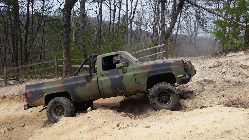

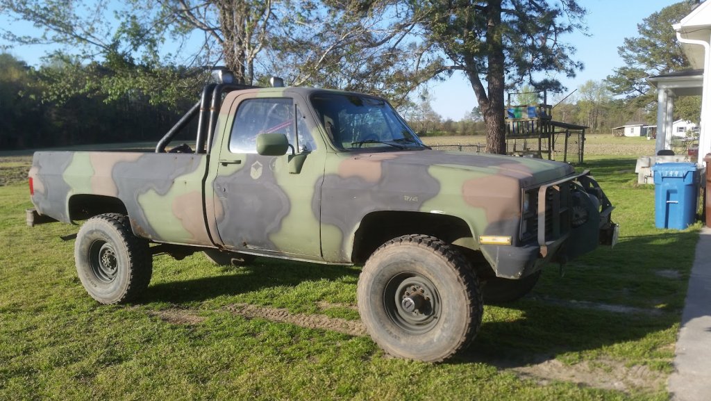

The last new lift kit that I bought and used was for my 85 CUCV. Superlift advertised this as a 3.5 lift for the K30. Trucks with Dana 60's sit an inch or so higher due to the raised spring pad on the passenger side of the differential housing. I was able to run 36 IROKs with the lift and a bit of fender trimming.
Getting a 2 inch lift for the 1/2 ton truck should clear the 33's with no problem; a 4 inch lift should be overkill. Here's a pic with the 37 radials and 36 IROKs.
