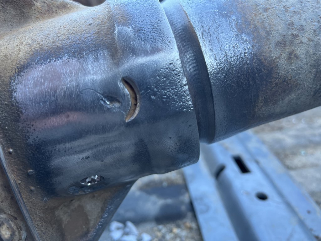

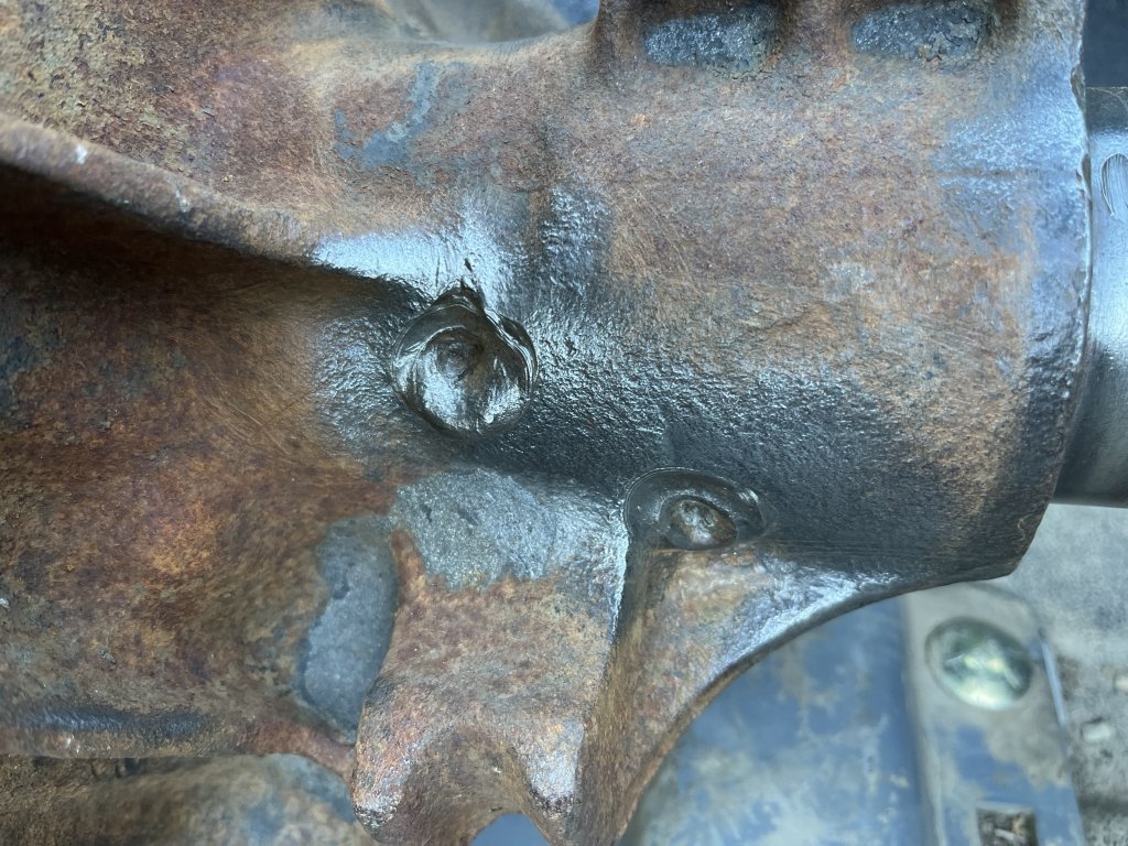

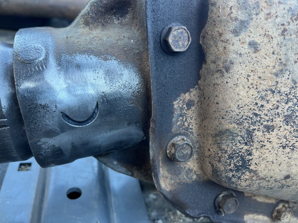

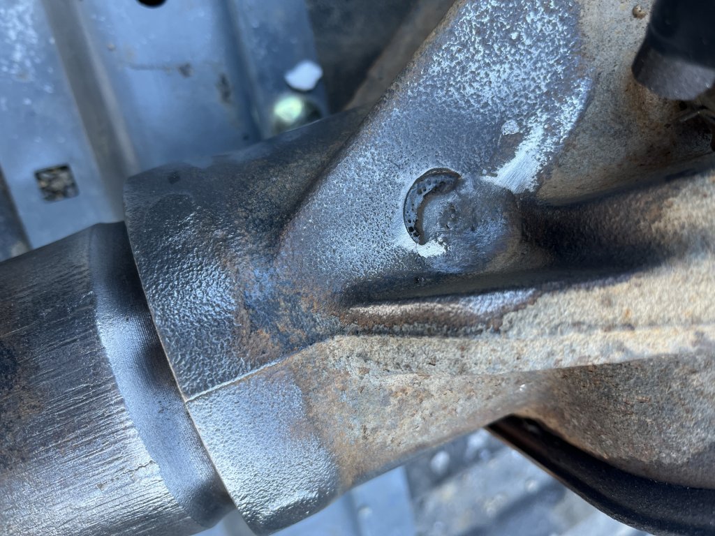

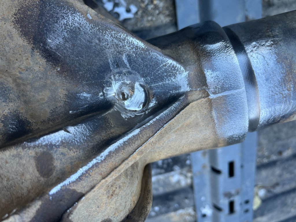

Cleaning up a 14 bolt and Dana 44. Both center sections were leaking through tube plugs. Looks like someone attempted to weld them. They look like garbage so going to have them cleaned up and Tigged. None of the welds fully penetrated or filled the plug hole.

Yeah it happens- you can mug them or tig if you really want to.
