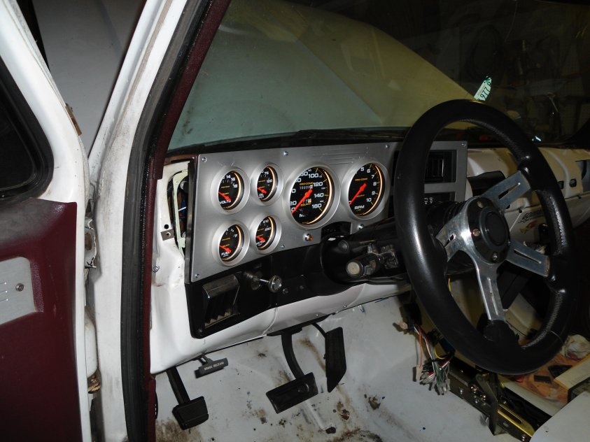

[/IMG] This is what I went with. Pretty straight forward. Many 10 owners have gone this route.

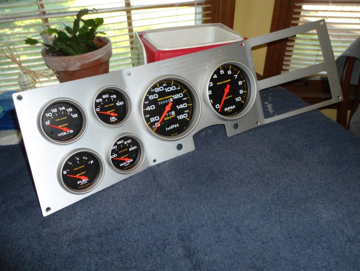

right here?
ok, here it is

Amcmanis
Jun 18, 2015
10
festus
alan
What size are the smaller ones I made my own metal plate but that looks so much better

C-10
305 c.i.
and installed
better than stock I would say.

2 5/8"

Anyone have part numbers on the metal plate and gauges?

The plate is an LMC item. Pro Comp gauges,...water,5437...oil,5427...fuel,5415...volt,5492...tach,5160...speedo,5154... Also purchased....Painless Performance universal gauge harness,30301

Ty, I'm trying to figure out if I want to buy all the stuff and do it myself or buy the full kit and just wire it up

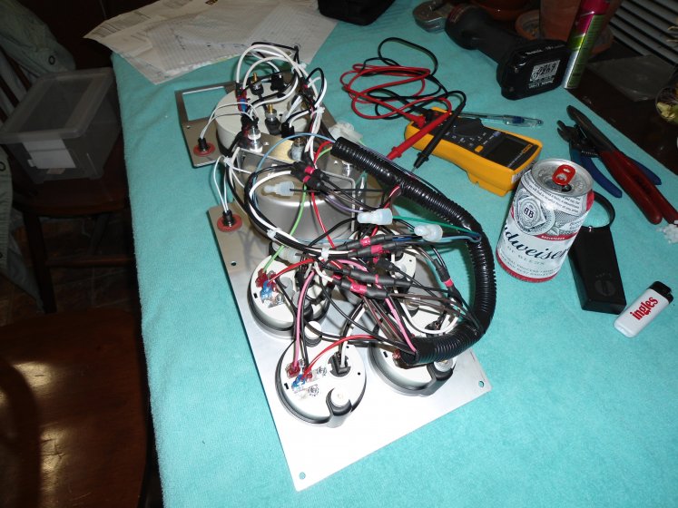

more pics
a good shot of the backside

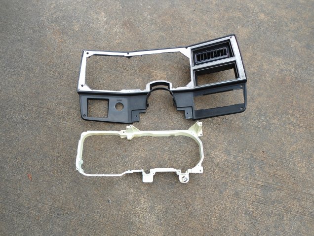

what was left
All this was done to get 'em in place.

OkieChoctaw
Mar 6, 2016
Oklahoma
Carl
4.1L
How does the view of the gauges look from the drivers seat? I started a similar project a long time ago on a 1976 C10... but the gauges were tilted down to see straight from the drivers seat and caused parallax error with the needles.
I see that Auto Meter also has a nice gauge mount cluster for the 73/88 squares too... but MSRP is like $350.00! It also looks like the gauges tilt down too.
Just curious as to your results with the LMC product. I didn't find it with a cursory search.
Looks nice! :)

yep, they do tilt down a bit , no needle errors as of yet. guess time will tell?

update...... Ok, after researching the "parallax" effect, or error, as was noted, yes, it is a common phenomena with vehicle instrumentation. The drivers view of the speedo will show 60 mph. , while the passenger's view of the same gauge may show 55 mph. So with that understood, sitting directly in front of the gauges, (and the angle of the cluster being 2 deg. down), very little "effect" is visible. Thanks to our dual eyes with their overlapping visual fields. Hey, good question. Hope this helps others.

Looks great...I've been trying to dream up what to do with my old messed up instrument cluster, and that looks like a better option than me cutting and bending a plate.
Pardon me being so square, but when you say those couple of plastic pieces are "done"...you mean that is what was removed and discarded?
