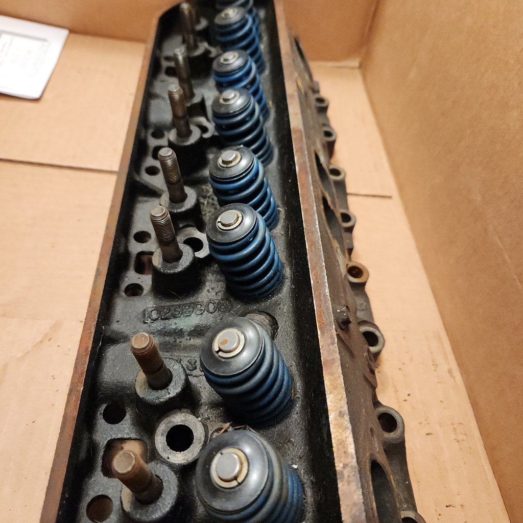

And the lift limitations are easy to fix with Comp 787 retainers and 648 locks. LS6 beehives spring or their replacements Comp 915, 918. GM does the same on the 604 crates.
Or Alex's parts drop in kits. He's got 3 depending on cam
I wouldn't buy a new set for the price but if I had them already I would use them. No machining on these and good for .530 lift.
