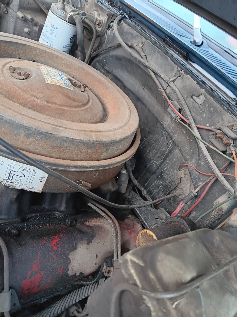

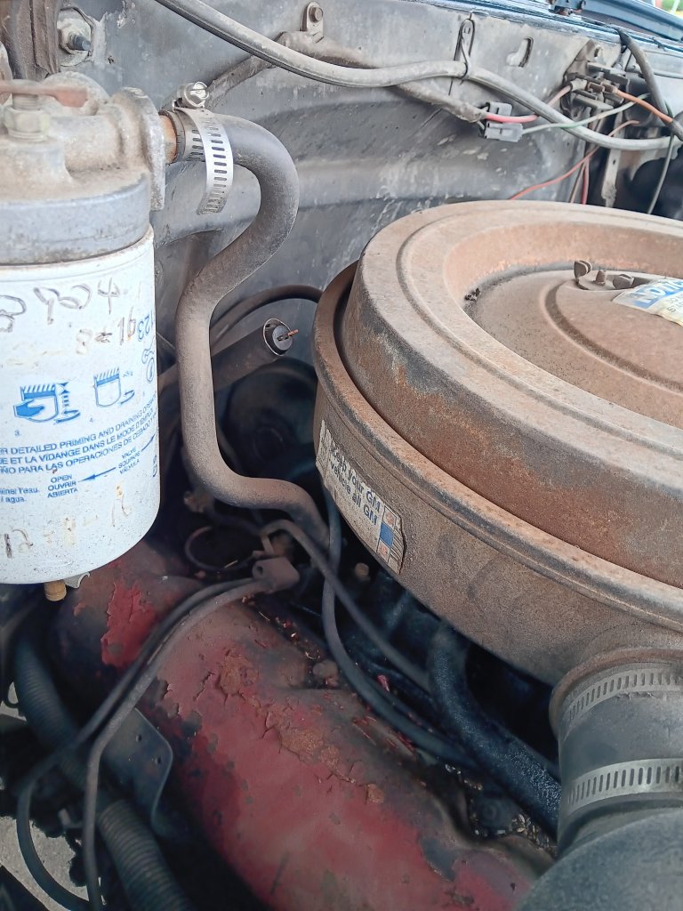

Anyone else have this "Turbo Diesel" plaque?

Never was a turbo diesel square. Aftermarket.
Would you happen to know what company would have included that plaque? It's a Detroit and as far as I know there was Banks and ATS for turbo options. Truth be told I still can't find were my turbo is but you can hear it loud and clear!

Wheres the other end of this go to? Opposite the motor
The intake muffler should connect to the rad support.

@TheBigBlue2500 I'd suggest you check your exhaust for a harmonica or the whistle that came with the Turbodiesel badge, because there is no turbocharger on that engine. :(

That fender emblem looks really familiar, but I can't place it. I think it's OE, just not from a GM truck.

Not sure what you’re taking pics of, but there ain’t a turbo hooked to the intake. That’s a factory NA setup afaik.
That would never pressurize.
99% sure you got no turbo just the stickers!
