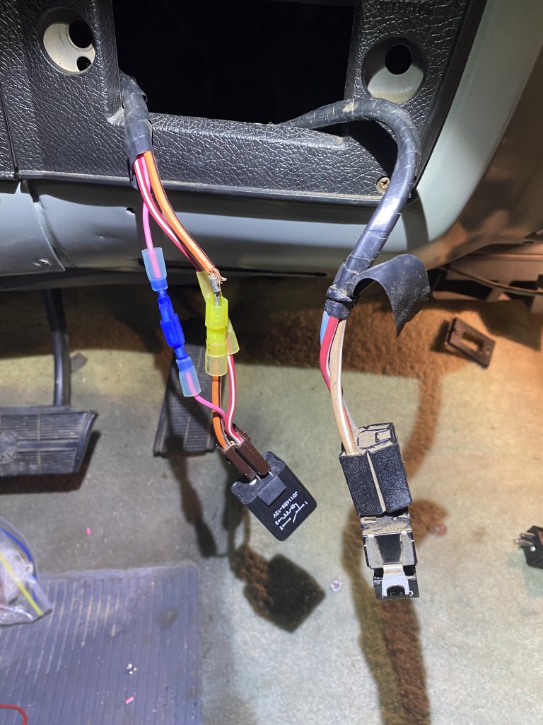

Here is the factory installed relay in my '78, and the connector that I bypassed to give constant 12v to the dash switch:
31,999
32,963
How it works is, the relay gets a constant 12v (red wire) and it is self-grounded by being mounted to the brake pedal mount. There is the little wire (pink/black) that gets IGN 12v and energizes the relay, sending 12v (orange/black) to the dash switch.
I simply connected the red wire directly to the orange/black wire.

Self grounding....I had a feeling that’s where it all went wrong. All I can get at the auto parts is plastic.
31,999
32,963
You just have to run a separate ground wire to use a standard type relay. Up above the left kick panel and behind the dash, there should be a set of ground terminals and you can just utilize one of the extra ones. Then you don't even have to drill a screw hole anywhere.
