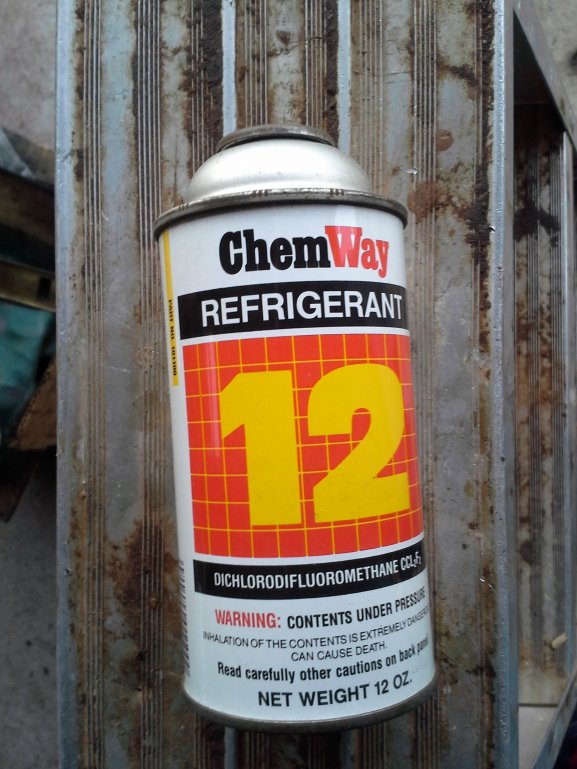

i found a can of R12 behind my seat, thing is we converted to 134A back in 94, Checking the A/C the switch is going bad i think the blower thankfully is easy to remove under the hood, but you have to hit the switch just right to get the blower on full blast.

Might try putting that can of r12 up for sale, r22 hasn't been made for a long time and a car restorer might absolutely have to have it for his perfect restoration.

This stuff?
No clue why it was behind the seat, it was converted back when i first drove it when i was 16
