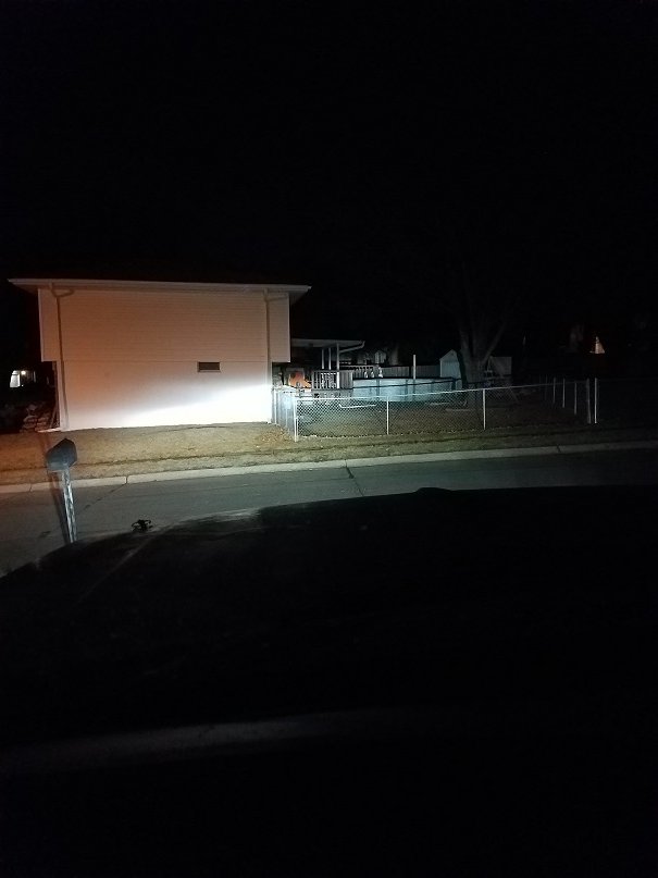

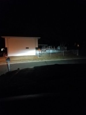

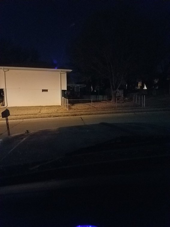

ill see if I can snap some pictures tonight when it gets dark. its amazing how different they are
