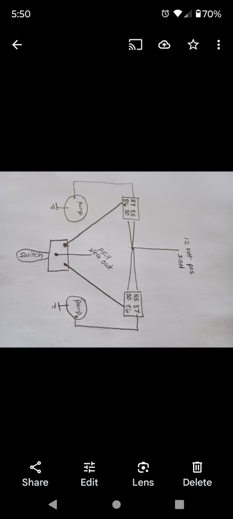

Mike, did you use the EFI tank kit with the separate fuel pump and sending unit ? I see the Pollak has a max of 65psi how did you regulate the pressure before the Pollak ? How do you wire it to have one pump shut off when you switch to the other tank ? Sorry for my lack of knowledge of the inner workings of dual tanks
If you're regulator is set at 43 or 58 psi, that's the max pressure any part of the system will see. It will only go above that if you have a restriction somewhere ( kinked hose, bent tube, etc ). You will need a second switch and a relay circuit that only controls the pumps. The valve and fuel gauge will remain stock with the OEM circuit. I'll post my diagram here shortly.

Sorry for the delay. I had to search my phone to find this schematic. This is how I run my dual tanks, EFI with 6 port valve and OEM fuel gauge. Actually, Dakota Digital but it works either way. This is a separate, additional circuit from the factory two tank harness. Easy-peasy.

Thanks Mike it's becoming a little clearer now I think, a dude pm'd me and said he wired everything through the stock dash switch which is the slickest way to go but in my case the amperage draw of the 400lph pump would likely melt that switch or worse ! So I'm assuming I need to run a Pollak 30 amp on/on separate toggle to switch the pumps and leave the stock wiring for the tank switch if that's correct ? Now did you purchase 2 pump relay wiring kits ?
I'd think you would be in good shape using the factory switch to trigger a 30A relay for the pump, so that the switch is only handling the relay trigger current, which is what SquareRoot was showing on his diagram if I'm not mistaken.

Right but if I remember correctly Mike is running the stock switch to operate the Pollak switching valve and gauge sending units and his diagram is actually wired to a separate toggle to chose the pump he wants to run….

Right but if I remember correctly Mike is running the stock switch to operate the Pollak switching valve and gauge sending units and his diagram is actually wired to a separate toggle to chose the pump he wants to run.
Correct. I want to keep them separate for ease of troubleshooting which has come in handy. I don't mind the extra switch. I did not purchase a "kit" I just wired it up myself. A two pole switch, two BOSCH or PICO relays and 12 gauge wire is all that's needed.
I have been looking at the latest solid state relays that have multiple (4) built in relays to clean up my relay "farm". lol. I have headlight relays, fan relays, lightbar relays, door locks, alarm, etc., and I don't like how it looks. It's busy. In doing so, I was curious about the difference between the 30 and 40 amp models so, I did some fact finding.
Using my pricey Fluke multimeter I stole from work for a day, I measured the actual current on several of the circuits. Now realize there is "in rush" current that happens for a split second on startup, and then there is operating (continuous) current.
On my SPAL 11" fans the current was around 11 amps continuous per fan. On the EP381 Delphi pumps they never exceeded 5 amps. In other words, 30 amp relays are generally more than adequate for about anything one might encounter unless they start daisy chaining devices on the circuit.
