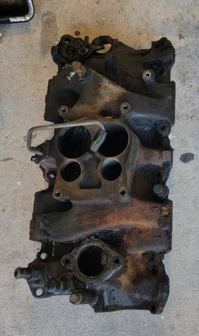

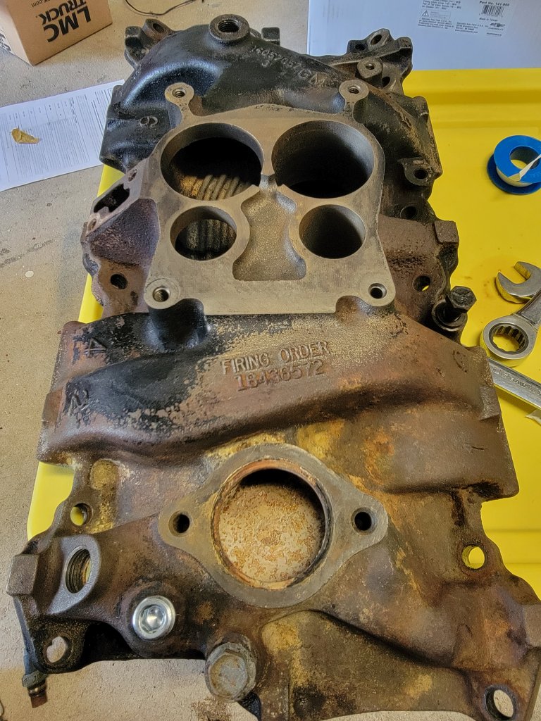

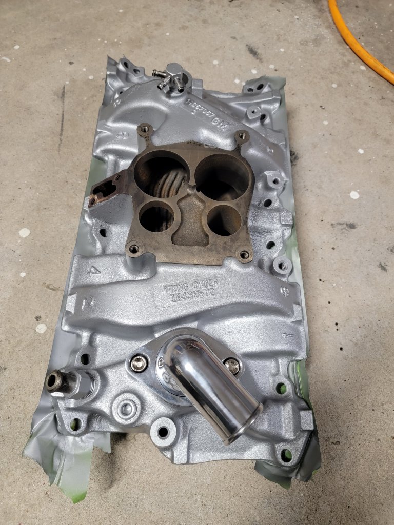

Also, a few pics...

Well, your new old intake looks great!
And from reading your other post(s) in the past, I wouldn’t spend $5 on “performance” bolt ons for a stock 80s engine.
Clean it up, make it nice and shiny fix leaks, but if you want noticeably more performance, save the $ unless the bolt ons you’re buying specifically are going to work well with your future plans for the engine you’re going to use.
