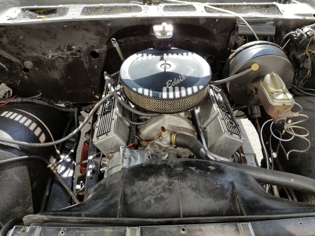

I took all of the HVAC stuff off of my 78 K5. I live in a temperate area and don't see the need for all of the complications and gas consumption. It really cleaned up the engine compartment.

Thats kinda what I was thinking. Its alot of real-estate to keep cool. My daily beater van has ac and I only use it while on the phone. I think I'm still gonna pull it all out and have on the shelf for if I ever find the rear ac unit.
The engine compartment does look alot cleaner with it not all in there i agree. Especially when the ls goes in it will be nice and clean under the hood
