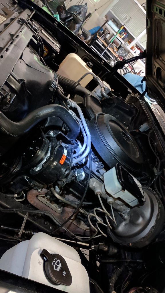

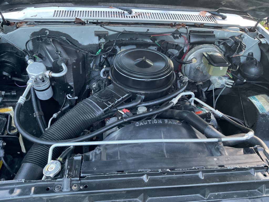

Two questions...could anyone post engine bay photos of a 1980s truck with AC showing original hose/line placement? I'm adding AC to my 1983 GMC and have the lines but want to make sure I'm running them correctly.

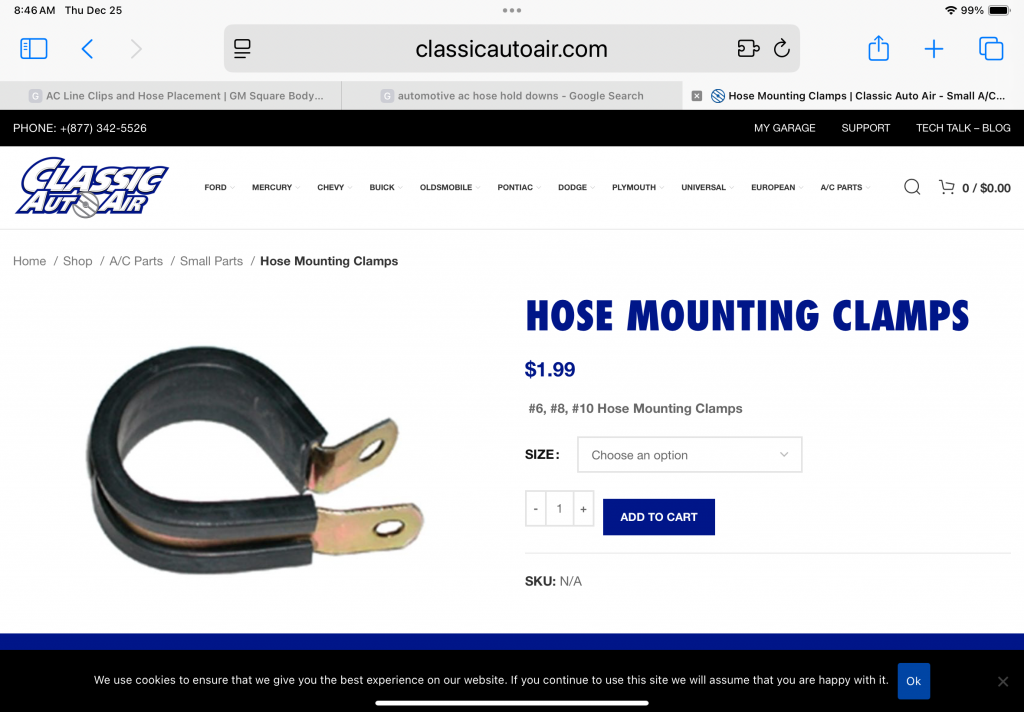

This leads to my next question, does anyone reproduce the clips for holding the lines in place such as to fan shroud etc.?
Thanks!

Loren
Silverado c10
‘84 California C-10, not sure if it’s the same.
Summit also carries clamps, the OE is a little different

Ron Sebastian
Nov 8, 2018
347
473
Vero Beach
Ron
Custom Deluxe V10
87 350 TBI
