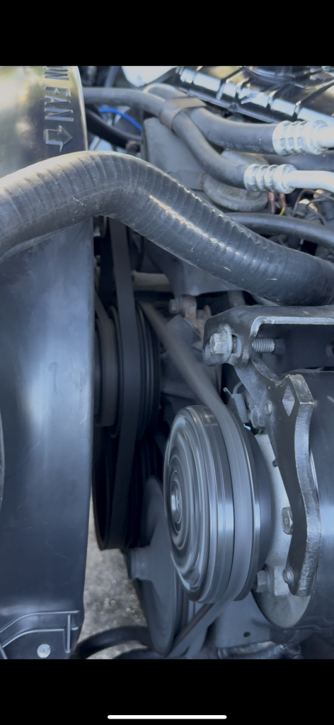

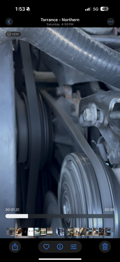

Only happens when AC is turned on . 1986 Chevy c10 305 5.0. Belt vibrates rough. When I turn the AC off and the compressor is not engaged , the belt moves normal. Should I just add more tension to the belt?

Not that this helps, but I had the same issue in the past and for the life of me I cannot remember what I did to fix the problem. I think I might of just tightened it a little and determined it wasn't going to bounce off. A year or so later, I ended up having to replace the compressor and I don't think it bounced as bad after that.

There is a small bracket under the compressor that occasionally is left off. Will vibrate without it. Just looked at one mounted it's impossible to get a decent picture. May be someone can post an exploded view.
Other possibilities are belt as previously mentioned, bad compressor, pressures that are out of spec, high, overcharged.

If the system is functioning normally,
and there is no abnormal noise when the compressor is engaged
and the compressor isn't loose in it's brackets
then, tighten the belt.
If the belt is more than three years old replace it.
